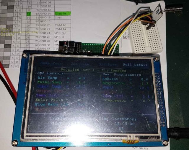

Anyone tell me where I'm going wrong here?
All my MM's have ESP-01's & HC-12's.
Wifi on the console, 433mHz on Com1.
All working OK & even the dodged up breadboard experiments were fine,
but the one pictured below is giving me grief.
Wifi is fine on it. but the HC-12's not receiving.
If I remove the Wifi module it receives....
Voltages are fine. 3.33 & 5.02, & the ESP has it's own AMS1117-3.3.
0.1µF on input & output & also a 100µF on the 3.3V out.
The HC-12 just gets it's power from the E100, but has 0.1µF across Gnd & Vcc.
The similar thing I made for the CGMicro 64+ works fine, & I don't think it's the 2 transmitters being close, as I tried the moving the HC-12 to flyleads & still the same.
My other E100 has both modules on a Proto board making a 3 layer sandwich & it's fine...
Have checked both E100's, swapped ESP-01's & HC-12's around & all modules work fine elsewhere. Even tried jumping a 1000µF electro across the HC-12, no change.
Got to be something dodgy with my power...
Any suggestions?
Phil.

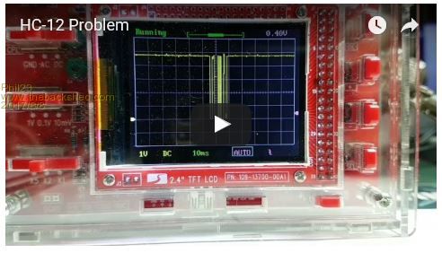

Still tearing hair out here on this; ignored it until 5 minutes ago.
Just put the Wiz BangGood DSO138 scope the TX pin of the HC-12.
Can see the pin sitting at 5v & spiking low when data is received with the ESP unplugged.
Plug it in & IF the ESP connects to the AP, it drops to 3v & stops swinging all the way low.
Only dips down about 0.25 V from it's high state.
IF I unplug the cable in the bottom left of the first photo (6 Pin), the Coms signal out of the HC-12 returns to normal.
That plug just has the 3 wires for the console connection to the ESP-01, it plugs onto Con6 of the E100, just using 3 of the 6 pins, Gnd, Tx & Rx.
Can't see how that could possibly be holding the HC-12's Tx high.
It's all wired fine. no 3.3v goes near the HC-12 & I've lifted the diode that clamps it, even shorted the 1k series resistor in the Tx line.
Just cant find a wiring fault.....
The console connection works fine regardless of what the HC-12 is doing....

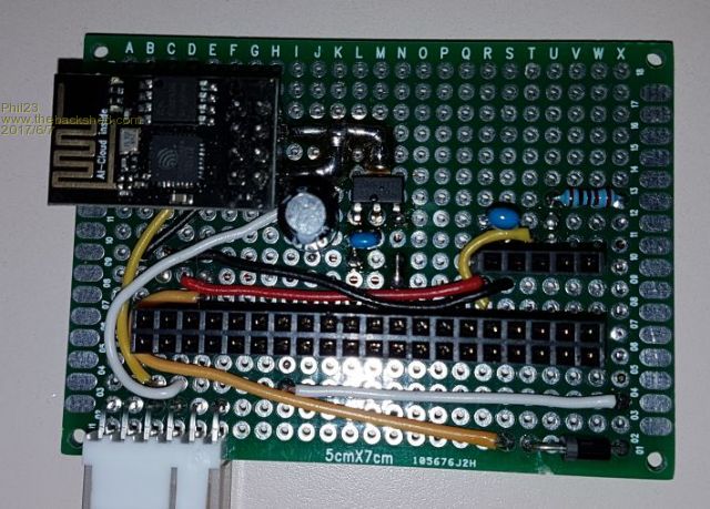

Could it be something dodgy with the way I've setup the AMS1117 to power the ESP-01?
I've got a 0.1µF on In & Out to Gnd & 100µF electro across the output.
Pretty obvious what's going on now, just don't understand why?
What happens as I disconnect the console cable.
Phil23
Joined: 27/03/2016
Posts: 1667
Posted: 09:24pm 07 Jun 2017
It's actually connecting the Rx line (Pin89) of the console,
that Pulls the Tx line of the HC-12 low;
the Rx Pin for Com1 (Pin 88).
It's got to be something to do with me running the ESP on it's own 3.3 reg & the HC-12 on the E100's 5V rail.
Does any of this make sense?
And like I mentioned above this 2nd E100 is fine if connected to the other proto board that's usually on the other E100.
Phil.

  Phil23 said  And like I mentioned above this 2nd E100 is fine if connected to the other proto board that's usually on the other E100.
Might renig on the above,
I may not have connected the console lead when I swapped the Proto board between E100's, I didn't connect the console fly lead.
Was more interested in seeing the HC-12 work at that stage.
Problem solved now!
Short between pins 88 & 89 on the 2nd E100.
Bit of a scratch about between them with a pin & it's now working fine.
Did think I'd stuffed things for a moment when at first the code didn't run, & no data on the display.....
Had just not plugged the RTC back in & it was crashing at that point.
