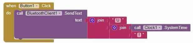

As an aside, I have just completed a project that uses an HC-06 bluetooth module on a MM and it spends days just waiting for something to do. It needs a good RTC but has none! I used the clocktrim to get things close enough (drifts about 20 secs over a day) and the android app transmits the unixtime with each command... the MM gets a clock "just in time" each time and that will be stable enough to hold things together while it is in use.
... string recieved from HC-06 expecting stuff like $U1505057122795!
dt$=HumanTime$(Val(Mid$(b$,3,10)))' mask last 3 digits of UT
On Error Skip 1:Date$=Left$(dt$,10) ' set the clock (GMT)
On Error Skip 1:Time$=Right$(dt$,8)
Print Date$;" ";Time$
... rest of code
and the codeflow on the android app does this:
Edited by CaptainBoing 2017-09-21
