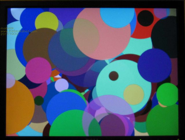

Please find attached version 5.4.14
2017-10-30_185432_mmbasicjessie.zip
2017-10-30_185448_mmbasicstretch.zip
This includes the ability to use a conected HDMI display as a LCDPANEL
OPTION LCDPANEL HDMI
See the video to watch GUI test running on a 1600x1200 HDMI display
The code automatically reads in the display size and MM.HRES and MM.VRES are set automatically for you. The display is in full 32-bit colour (RGBA).
The code works best on a Pi running Raspbian Lite as the Pixel GUI will break through the Pi-cromite display - anyone know how to fix this?
On a Lite install it works best if you disable the login prompt and the cursor
To disable the login prompt use
sudo systemctl disable getty@tty1.service
to disable the flashing cursor use:
sudo su
setterm -cursor off > /dev/tty1
All normal graphics commands are available including transparent text and BLIT and GUI commands will work as normal. Of course there is no TOUCH capability and mouse control of the cursor is a problem for another day.

Posts: 11886
Posted: 11:15am 30 Oct 2017
  Quote  Do you think a single point TOUCH could be implemented somehow on these screens
Yes but I don't have one to develop/test
  Quote  Will OPTION LCDPANEL CONSOLE work by any chance?
No. that is a lot of boring grunt work and I'm not sure it gives any advantage over a separate SSH session
  Quote  IF SO, then does this mean we can use LOAD IMAGE to display much higher resolution images?
Yes, works perfectly now

Posts: 11886
Posted: 10:48pm 30 Oct 2017
  Quote  is MMBASIC useable on a full GUI install enough to see the graphics on the HDMI output.
It is fully usable but the clock and the load meter update in the top right and overlay the image - only a tiny area on a 1920x1080 screen. This can be largely negated by doing BLIT READ of this area and then BLIT WRITE at frequent intervals. This restores the contents of the mmbasic framebuffer to the screen
Of course, if you start clicking with the mouse other areas of the desktop will "break through".
To stop screen blanking on Lite
sudo nano /boot/cmdline.txt
Append " consoleblank=0" to the end of the line
To stop screen blanking on Pixel (Stetch: not tried on Jessie)
sudo nano /etc/lightdm/lightdm.conf
in the "[Seat:*]" section insert the line
"xserver-command=X -s 0 dpms"
In both cases reboot for the change to take effect

Posts: 11886
Posted: 12:32am 31 Oct 2017
Updated manual with OPTION LCDPANEL HDMI and details of helpful Raspbian mods in Appendix E
2017-10-31_110439_Pi-cromite_Manual.pdf
I've also now found how to get a clear screen on a Pi with the Pixel desktop
First stop the desktop:
sudo systemctl stop lightdm
Then stop the flashing cursor:
sudo su
setterm -cursor off > /dev/tty0
NB this is a different tty device than used in Lite
To re-enable the desktop
sudo systemctl start lightdm
This version of the manual also includes details of the JSON$() functionEdited by matherp 2017-11-01
