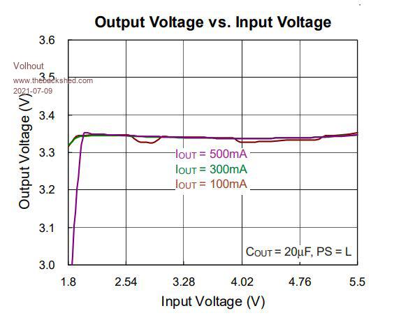

Posts: 4836
Posted: 05:44pm 09 Jul 2021
Hi Mixtel90,
First of all, i found the problem with the distortion of the trace. The pwm filter had a component with wrong value. The picomite in default config after reboot works adequate for this application. No linear regulator needed.
About the voltage range, yes, you could lower it. But mind that if you want to probe a 3.3v circuit for a defective esd diode you need at least 4v at the probe tip, add the voltage over the measurement resistor, and some headroom for the amplifier, you easilly need +/- 6volt power rail. My design can also check 5v circuits, and even measure zener diodes up to 12v. Again, those where.my design goals, yours could differ....
Anyway, a low voltage design is definitely possible. The software only needs adaptation in a few constants. The hardware change is also simple.
As to answer your question on the -3.3v. I am not sure if that will work with the buck boost in pfm mode. In pwm it will, only you get -5v.... not -3.3v....
P.s. Check the schematics, the pwm is amplified and level shifted. The ADC input is also pre-biassed to centre the input voltage around mid 3.3 v
Edited 2021-07-10 03:48 by Volhout
