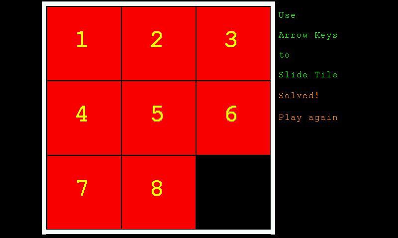

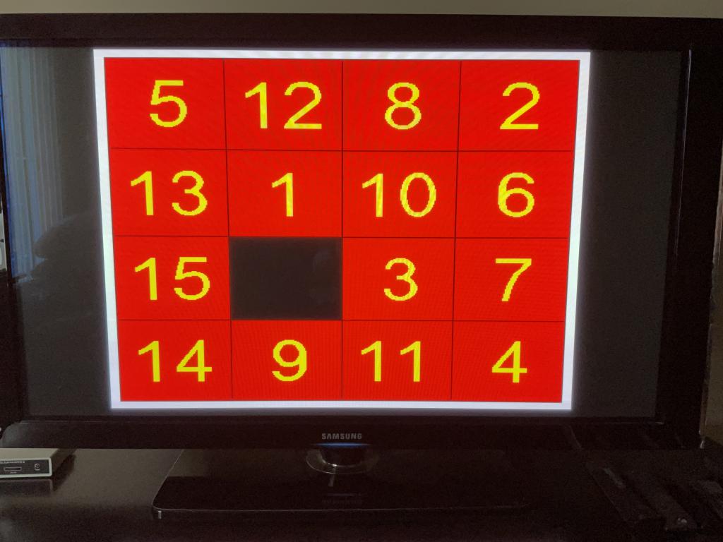

Here's a version which works on the Armmite F4 with the IPS/OTM8009A 800*480 LCD. I think it will work with other micromites and other LCDs, but I didn't test that.
The biggest trick was adjusting all the x and y coordinates for the LCD size. I calculated pixRatio! like this:
pixRatio=min(mm.hres/1024,mm.vres/768) ' CMM2 mode 9 is 1024/768
I did some fiddling to get some text items to display in the proper place.
Here are samples of the 3x3 through 10x10 screens (it's all crisp on the actual display).
I had to change two color items--GREY is not an alternative spelling of GRAY on the F4, and ORANGE is not available: I used BROWN instead (which looks orange--maybe see previous discussion about how "brown" cannot be generated with light, except as our eye interprets orange based on the surrounding colors).
I expanded the INKEY$ processing a little to get the appropriate single number for the arrow keys from the escape sequence which the F4 provides (like other micromites).
Here's a winning game:
I'll admit that it did not even attempt to play beyond the 3x3 level, but I don't think I did anything which would cause the program not to work as on the CMM2.
I briefly backtested on the CMM2 with a VGA->HDMI->USB3 link.
