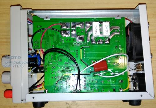

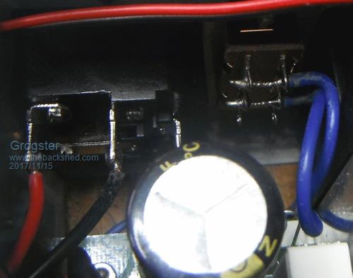

I thought I would try out one of the cheap Chinese power supplies available on eBay and the like. Not expecting very much, I ordered THIS ONE.
Supposedly capable of 30v and 10A, fully adjustable voltage and current limit.

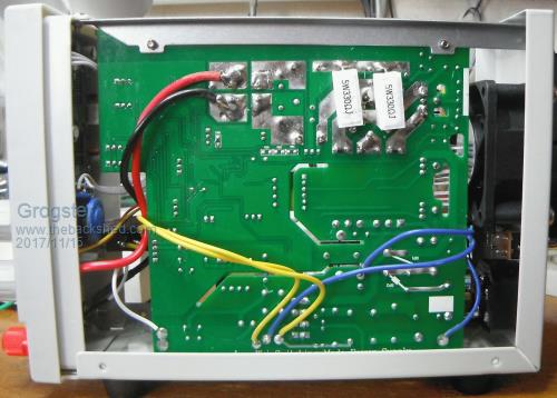

It arrived today, so the very first thing I did before even plugging it in, was to rip it open and give it a basic visual inspection. Mainly I wanted to evaluate it's mains-voltage compliance or lack of, before plugging in something that could actually be very dangerous.
Quite nice inside considering the price! Air-gap slots to separate the HV from the LV sides of the PCB, which is always nice to see with anything connecting to the mains. One thing they are doing, is that the main on/off switch is in the Neutral - naughty, naughty. That along makes it non-compliant as the phase side of the AC is still present at any point on the HV side and earth, even with the switch off. I will be changing this to switch the phase as it should be. That's my only real complaint on the HV AC side. Quite good separation in the AC paths, and acceptable distances between phase and neutral on the PCB unlike some things I have seen. Nice grunty output wires, and inductive filtering on the main DC output.
Component side is nice. Clean and tidy. All the SMD factory stuff is as good as anyone would expect. The hand-soldering is not too bad. Not super-duper cos they don't have any insulation over the HV wires(they are just exposed inside the case), but electrically functional and solid enough. I give that a pass, but would prefer to see insulation - but then, for the price of this thing.....
Mains input and voltage selector switch soldering.

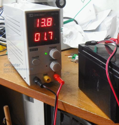

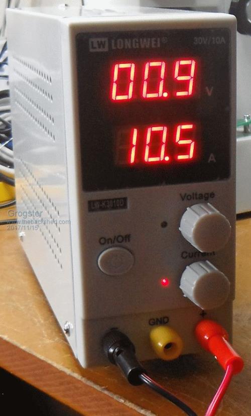

Running with a gell-cell battery as a load. Currrent limited to 2A - seems to be working.
Load test. Shorted output. Can indeed supply 10A. That could make a big bang if you are not careful!
Voltage is adjustable from 0.00v to 32v. Voltage control knob is a multi-turn pot, so the control is nice, and you can easily adjust in 100mV steps. Adjustable voltage is nice and linear all the way from zero volts up to 32v across the entire range of the voltage control.
Current is adjustable via the other knob, and this is a standard pot not a multi-turn one. Adjustable current limit from zero right up to 10.5A in 100mA steps. This control is a little more coarse in adjustment then the voltage one, but still easy to use.
I would still recommend this to anyone looking for bench power supply with full current limiting. The only thing that I really am frowning on is the fact they are switching the 230v(or 110v) neutral on the main on/off switch, so that needs changing to be compliant, but for the price of this thing - knowing you have to change that - it is still a great deal if you ask me - and you didn't....
I am considering buying another one, as I often need two voltages at the same time on my workbench.

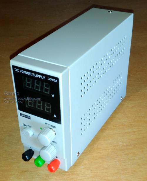

I bought a similar one off eBay a few months ago. It was a 30volt 5amp model, for $44 plus $1 delivery. Externally it looks identical.
Like you I took the top off to check it was safe, and I was also impressed with the build quality. I've used it a few times since then, works a charm. Only issue I had was the current meter reads a little high, so 5 amps is actually about 4.2 amps, and that was the limit of its output current. But for my purposes, and for the price, I'm more than happy with it.
Having built several variable power supplies in the past, in future I wont, I'll just buy another one of these

I've just checked the bench PSU against my old-trusty multimeter, and the PSU output voltage is out by about 50mV - nothing of any significance.
Current accuracy against my old-faithful is about 80mA out, but then, this is not a lab-certified PSU, and is close enough IMHO for the price.

One thing I noticed was the seperate Ground and Minus connection. I wonder if there would be any problem with powering something that was already grounded. Curious, take a multimeter and read the resistance between the two, unpowered of course. Then with it powered on read the voltage between the two. It would be nice to know if the two could be connected together. All of my fixed voltage power supplies ground the minus or negative connection.
Max
Posts: 10043
Posted: 05:46am 15 Nov 2017
Your wish is my command.
Resistance (PSU off) between negative(black) and ground(yellow) is infinite. There is no circuit even on 20Meg-ohm.
Voltage between negative(black) and ground(yellow) with 12v output is zero.
Voltage between positive(red) and ground(yellow) with 12v output is zero.
Ground(yellow) is connected to mains earth inside the case.

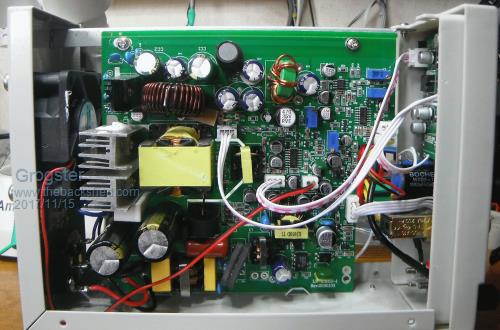

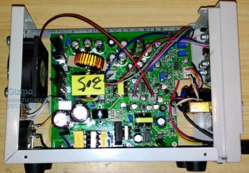

This is the 5 amp model I bought. I took the photos when I had it apart, anything mains powered from China gets the once over.

In Europe the mains plugs can be rotated. This means equipment does not know which wire will be live. On/Off switches must disconnect both wires.
Being compliant over the world is a major pain.
Posts: 10043
Posted: 02:48am 16 Nov 2017
Oh, that might explain the switch in the neutral then. America would have that issue, cos their power plugs will fit in either way around, so I see what you are talking about there....
I guess it does not matter for personal use - just so long as you don't on-sell it with anything in that configuration!

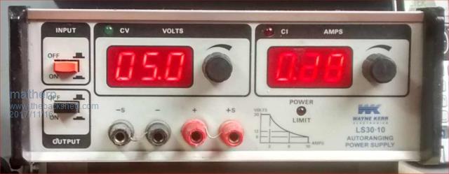

One problem with most cheap supplies (and I assume this one) is that you can't set/see the voltage and current with the output off. I bought a second hand Wayne Kerr (Farnell) LS30-10 off ebay for less than the price of this supply new. I can set the voltage I want and the current I want to limit at and then turn on the output at the selected voltage knowing it won't exceed the set current. It then reports the actual voltage/current when the output is on. Worth keeping a look for something quality second hand rather than cheap new IMHO

What's wrong with setting the current-limit and voltage you want, and THEN connecting the banana plugs? Achieves the same result. You could also add a suitable isolating switch to the front panel of the ones I have posted here if you really wanted that ability.

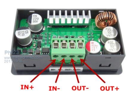

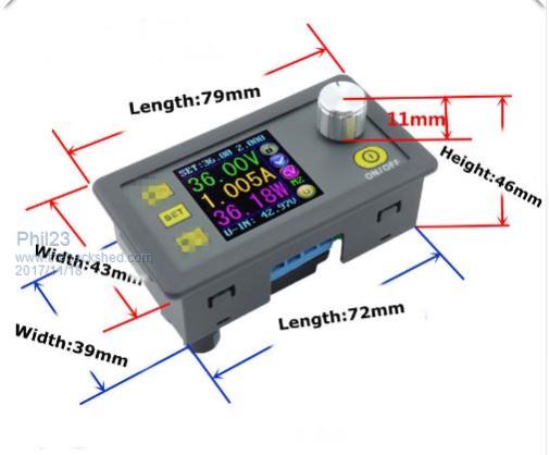

Just another thought, after playing with the DPH3205 module I have.
2 or 3 of the similar DPS3203 or 3205's in a box could make a cheap front end to the 10A unit.
Presume they could run in parallel off the 20-30V input & each can be programmed with 9 different outputs.
3 modules for under 100 bucks for a 3 output supply that's really easy to assemble sounds appealing.
Not 10A, but the option of 3 or 5V modules as long as the input is not overloaded.
Other thing slightly interesting, is that they boot up when input power is applied,
and the On/Off switch below the Pot enables the output once the parameters are set.
Set all parameters before output is enabled @matherp,
No pulling out banana plugs @Grogster.
Cheers.
