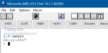

? MM.VER
5.0405
> ? DATE$
0
Error: Syntax
> ? DATE$()
0
Error: Syntax
What do I get rid of?

make sure there is a space after ?
try
print date$

Found it. The problem occurs in MMEDIT / VT100 mode!
@Tassyjim?

  drkl said   The problem occurs in MMEDIT / VT100 mode!
@Tassyjim?
drkl
Works for me...
Posts: 3368
Posted: 11:42pm 15 Nov 2017
BASIC is sensitive to the placement of spaces but in the next version one of the additional features will be more tolerance for missing or extra spaces. For example, a space will not be required after a ? (the above issue) and extra spaces after an array name and before the opening bracket will not cause an error.
