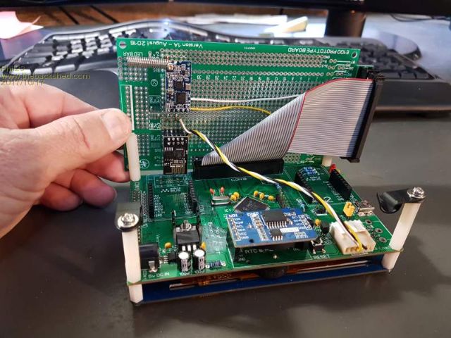

  Grogster said  Do any of the members here have any major problems with that concept?
ESP-8266 users will be compromised.
On mine I use the CP-2102 header for a plug to connect the ESP-01 as I mentioned here....
I could live without that particular connector, but as long as I still had access to Tx & Rx before the 1455, as on Con6.
All my MM's including the E100's are connected by Wifi & I'd be totally lost without that functionality.
Having to take a laptop & USB to all of them for code changes would be a huge PITA.
at should still be available via some means.
Think this applies to all devices using the 1455; Direct Tx & Rx Needs to still be available.
Phil. Edited by Phil23 2017-11-24

OK folks, thanks.
And Phil - you make a very good point, and hammered home well with the photos.
I think what I will do, is leave the CP2102 header and CON6 there, but perhaps change the SOIC 1455 to a DIL version, so that if you want the USB serial connection and/or the ASCII ICSP feature, you plonk the DIL chip into a socket on the E100 board.
I think that would then cater to everyone. Those that DON'T want it cos they currently have arrangements such as Phil, but also those that DO want that extra feature. This also means just one version of the PCB.

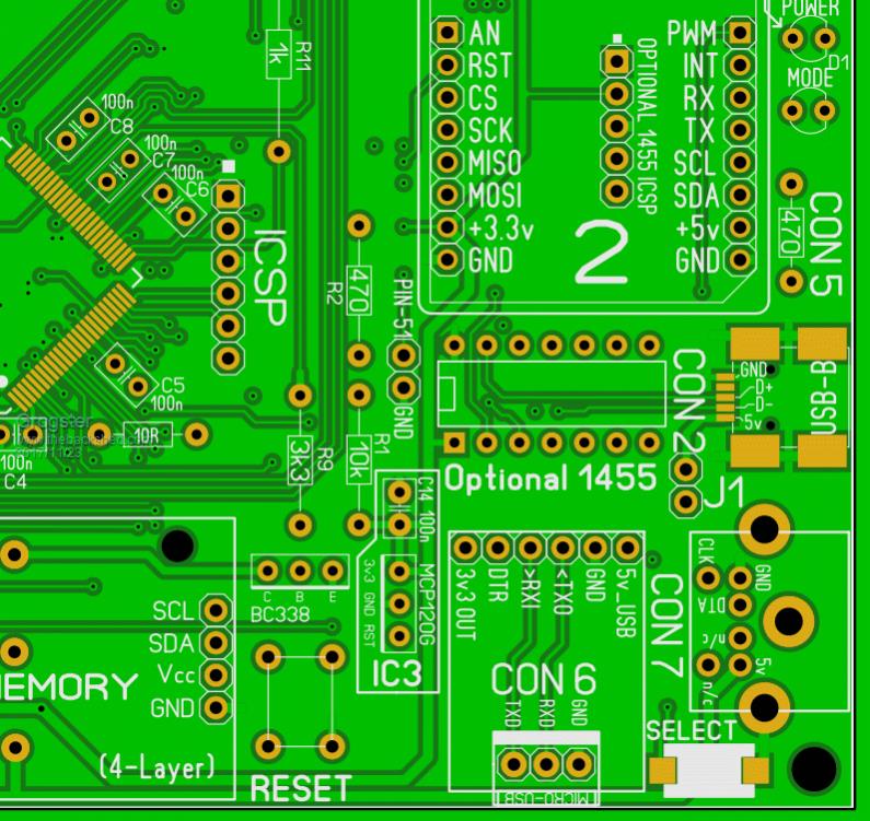

Posted: 01:02am 02 Dec 2017
UPDATE:
OK, here we are with the new design.
- Optional socketed 1455 USB/ICSP interface chip with on-board ICSP for IT
- Silkscreen changes as per WW request(around LED's)
- uSD card socket added(SD #2), upper-left corner.
- CON10 removed.
- PIN_17 added to PIN_51 header as a spare I/O pin.
I will probably tweak a few more things, but this is essentially the new version of the board I plan to get made.
