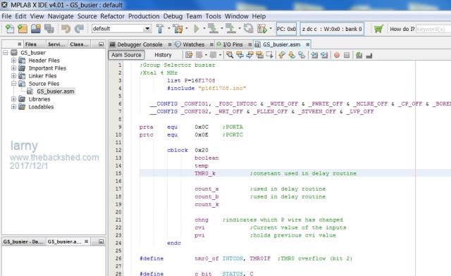

I recently downloaded MPLAB X since the PIC I'm currently using (16F1708) cannot be fully tested in MPLAB 8.92 since that PIC is not fully supported in 8.92.
I have been able to import the programme into MPLAB x, but I can't see how to test it. There is a daunting array of info available but I can't find anything to help.
In MPLAB 8.92, I used the function keys F7 & F9 to step through the programme so I could test it.
But with MPLAB X, I cannot find the equivalent facilities.
So how do I test my programme in MPLAB X?
Any assistance will be appreciated.

larny
Joined: 31/10/2011
Posts: 349
Posted: 01:48am 01 Dec 2017
Thanks vegipete,
I did all of that, but I still can't see the run, step over, etc icons.
The project complied successively. See the attachment.
I've tried everything I can think of to no avail. The Help did not help me.
I must be missing something, but don't know what.

Joined: 29/01/2013
Posts: 1185
Posted: 08:50pm 01 Dec 2017
Strange. When I select "Debug:Debug Main Project", I get the run/pause/step etc buttons. You can force them to appear by right clicking on a blank section of tool bar and checking them on.
(I'm using X IDE v3.61, for what that's worth.)
larny
Joined: 31/10/2011
Posts: 349
Posted: 12:16am 02 Dec 2017
Thanks Azure & vegipete,
This morning I managed to get it into the Simulator mode by pressing Simulator. Whereas that did not work yesterday. ???
When I tried "Debug:Debug Main Project" no buttons appeared. However, I'm happy to use the keys - F7, Ctrl+F7, etc. similar to V8. I prefer keys to mouse work as I have RSI from too much computer work.
I have V 4.01.
Someone on another forum said that when you open a Project, it should open in the same state as it was in when you closed it. The attachment shows the state when I opened it this morning.
I noticed the the File>Save is grey. I had assumed that it would save automatically when I closed it. In V8, it asks if I want to save if I attempt to close without saving.
I'm finding it extremely frustrating. Normally I can latch on to new software without too much trouble. Not so with this one.
So I'm wondering whether I should un-install & then install either V 3.61 or the latest.
What you both think?
Thanks for the comments, Len
