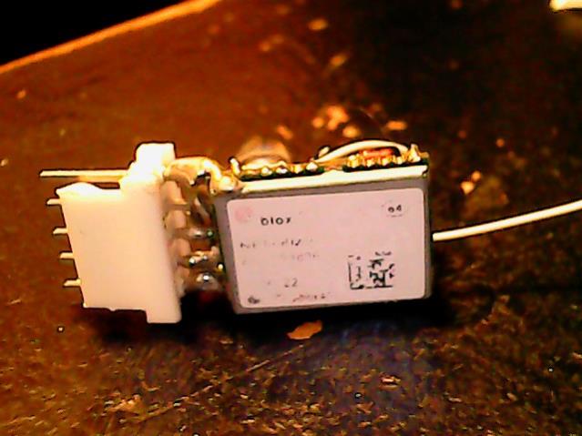

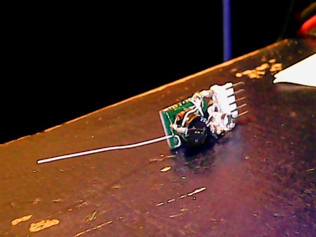

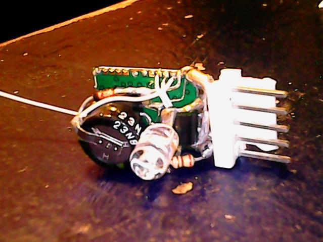

I had thought about sending a sync pulse every second or so to use as a timing tic for the slave microphones. However, this would require a radio receiver, in addition to a radio transmitter in each slave.
1. I don't like having to have have the master transmitter running all the time.
2. There are issues with switching from transmit to receive.
The use of a $5 GPS chip is more cost effective and they all produce a very synchronous 1 Hz time tick accurate to a few uS of each other. I like the ublox NEO-6M. I "Dead Bug" wired directly to the chip and used a short wire antenna. There is a small supercap for backup that lasts for at least a week. I would think it would be hard to beet the GPS solution. Remember, this doesn't move and has plenty of time to get locked to the satellites.
