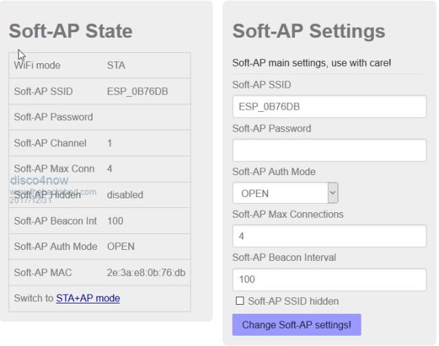

I have finally made myself focus on the task of getting the EPS-01s module flashed with ESP-Link and then talking to a E-28 MM. With the help on another thread I have done this and have now got the capability to program the MM with MMEdit over my wifi network - great.
I am now concerned that by having this wifi access point permanently on I have a security risk.
Opening the module with a browser to ESP-Link shows under "SOFT-AP' that the authentication is open. Should I set this to require a p/word? I think yes but not sure.
To be honest I do not understand a lot of what is show under ESP-link.
Help from the gurus pls.

Set WIFi Mode to STA mode and it wont be an AP anymore.It can be STA,AP or STA&AP which is mostly the current mode.

Spent some time reading the esp-link docs and now realise better what is going on. So when the esp is in STA(tion) mode it does not provide an AP (access point) function unless the combined mode is selected.
That seems to address my security concerns if it stays that way. What could cause the esp to switch modes other than my deliberately doing it via esp-link?

From what I understand,
When they first boot they go into AP mode so you can connect to it as an AP then configure the AP it connects to as a station.
So in theory, there may be that brief period where I could connect say my laptop to your ESP & then configure it to connect to say my mobile wifi thingy....
All that would be impossible if a password was set for the soft AP mode.

I have spent some time turning the esp on and watching the console log via the web browser.
It appears that when powered up the boot process is very fast. The module picks up an Ip address from the main dhcp server, then connects to the main router and then picks up the fixed IP address I assigned. This all seems to happen in about 10 secs but I can only go by what appears in the log.
As you say the esp is in AP mode at the start and then as soon as it picks up the fixed IP it goes into STA mode. At that point it is secure as far as I can judge. I think I will leave it as is for the moment as when I implement my links to the MM modules they will be on all the time and therefore not accessible from outside the gateway.
