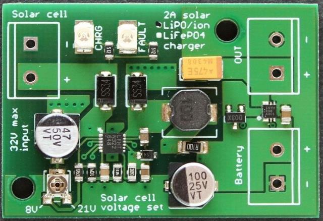

I am looking for ways to power my weather station when I mount the outdoor unit but I can't find any way to do it reliably
I've been using 18650 3.7V 3A (3000mAh) batteries and with 4 of them in parallell (12 amps) this will power it for around a month
I was hoping to use solar charging to recharge the batteries, and while during the summer months it did charge the batteries a bit, now in the winter months it's not getting any charge
I'm using a 25W 12V solar charger with a solar charging circuit that converts the 12V to 4.2 to charge the batteries

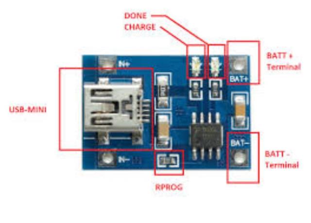

There's quite a lot of little Li-Ion charge modules about.
I use one with a pair of 18650's to run the FARS on my Weather Station.
Some use a TP4056, specifically a charge controller, & many also have a BMS chip (Battery management system), to prevent over discharge.
Have a look at some of these.
I've also junked a few cheap Phone Juice Banks as well for their modules & batteries.

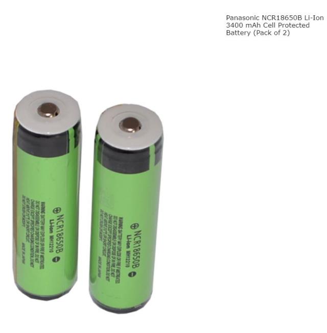

  lew247 said   I've been using 18650 3.7V 3A (3000mAh) batteries ...
Which brand of Li-Ion batteries? Maybe you should check the capacity.

They are genuine 3500mAh Panasonic batteries, and maybe "30" days was a little optimistic
The unit draws around 35mA when not transmitting data and around 65mA when it is.
I started off with the Solar cells going into a 5v regulator feeding a TP4056 module to charge the battery, this was working in the summer but now it gets no charge whatsoever as it's winter.
I then bought one of THESE solar chargers but unfortunately it's still giving no charge to the batteries, the sun doesn't seem to be strong enough in the UK during winter
This unit is only giving 1.55V to the battery to charge it which obviously isn't anywhere near enough.
The input from the Solar cells is 14.9V so plenty of voltage, I'm guessing nowhere near enough current though from the sun in this part of the world

I said I have 14.9V from the solar panel INTO the charging circuit and only 1.55 out of the circuit which goes down to zero when the clouds get heavy and at night.
Posts: 4380
Posted: 07:35pm 07 Jan 2018
Well why don't you have a decent charging voltage coming out?
Worst case it would be at low current but the voltage should be OK - right?

I have protected LI batteries with the protection built in
4 of these
I have a 12V solar charger going into this
The charger part is based on the LT3652 solar charger IC and charges lithium batteries (Li-Po, Li-ion, LiFePO4) at a rate of 1000mA (can be set to 2A max)
Tomorrow when the sun is out I'll measure the current coming from the Solar cells
In the summer I was using one of these fev via a 5v regulator to drop the 12V down to 5V
This was working fine during the summer but once autumn came it stopped working, I thought it might be the module so changed it for another and then eventually got the proper solar charging board I'm using now
Edited by lew247 2018-01-09

Your charger has a limit of 1 amp at 4.2 volts
Allowing for losses in the conversion, lets call that 5 watts required.
Your solar panel is 25 watts so even allowing for the London smog, there should be plenty available from your solar panel for a reasonable period of the day.
You need to measure the current coming from the solar panel and the current going into the battery with the load disconnected at (roughly) the same time. Also need the battery terminal voltage.
Measuring the output with the battery disconnected will confuse the controller.
With one amps out of the unit, there should be approximately 300mA coming from the solar panel.
If ned be, discharge the batteries a bit so you should be getting the full one amp charge.
The 14.9V you are seeing will be the 'Maximum Power Point' of the solar panel which is set by the trimpot on the controller. 14.9 sounds about right. The rating plate on the panel will have the correct figure for your panel.

I measured the current as well as the voltage from the solar cells today just after midday
Voltage 14.9V but the current is only 8.9mAh
I guess the sun really isn't strong enough to give any decent amount of current out of this cell pack

I think your logic is flawed. You're not showing much current because the load (your charger) is not attemping to charge your battery. Either your charger is bad or your batteries are. The supply voltage and load determine current flow. Without a load you have no current.
Connect a small 12V light bulb or any small load that would draw about 1 amp directly to the solar panel. You should see the solar panel voltage drop some. How much it drops depends on how much sun your panel is receiving. Now measure current. I suggested a light bulb because you will see instantly that your panel is working or not.
