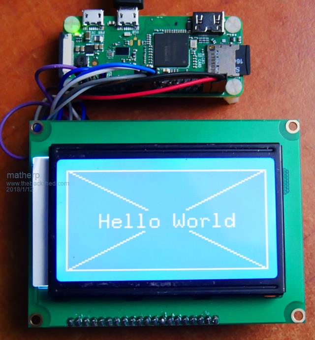

This fixes a bug in the PEEK command and also implements the USER display driver capability of Geoff's version 5.4.09. In addition it includes a new font #7 which is a small 6x8 font ideal for smaller displays. NB the Pi-cromite does not support loadable fonts.
This is a huge advantage on the Pi-cromite where we can't have CFunctions. MMBasic is very fast on the Pi-cromite and drivers in Basic perform well
The picture shows an ST7920 based 128x64 display (QC12864B) being driven by a SPI user driver on a Pi Zero-W. The code is attached below and will also work unchanged on any of the Micromites (other than adjusting the pin numbers)

In your sample code, you have the following:
Line 0,0,MM.HRes-1,MM.VRes-1
<skip>
Box 0,0,MM.HRes,MM.VRes
It appears the bottom right corner of the screen is in different places for the Line and Box commands. Why is that?
Posts: 11881
Posted: 10:09am 02 Feb 2018
  Quote  It appears the bottom right corner of the screen is in different places for the Line and Box commands. Why is that?
Check the MM+ manual
line x1,y1,x2,y2
box x,y,w,h
  Quote  The manual says that there are two serial ports COM1 and COM2. COM2 on the 7-Tx and 11-Rx pins. Can I reassign COM2Rx to a different PIN? The project needs COM2, and pin 11 is occupied by HAT.
At the moment this is hardwired. I'll look at it in a future release
