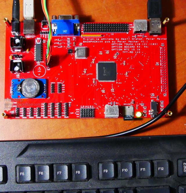

Attached is a beta release for the 100/144 pin Micromite eXtreme that supports a USB keyboard
2018-01-15_053507_Micromite5.04.10Beta.zip
At the moment the key layout is for a UK keyboard so US users will fine @ and " characters swapped and possible other errors. Australian users - I have no idea.
Please let me know any coding issue and I will correct them in a subsequent release.
To use the code you need USB connected to the chip in HOST mode which means VUSB must be at 5V and USBID should be at GND.
On the 144 pin Micromite eXtreme PCB ensure the shorting link USBv is made and put a jumper on USBv2.

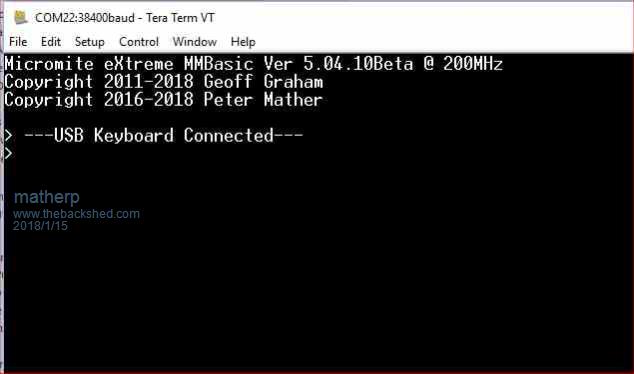

The code should enumerate the keyboard on boot up if it is already plugged in or immediately when it is plugged in. A message will confirm the connection. The enumeration doesn't seem completely reliable (this is true of the Microchip example program as well as MMBasic) but just reset a couple of times if required until it works - this may be because the PCB has fairly primitive USB wiring and the enumeration takes place before the keyboard is stably powered.
Once the connection is made the keyboard can be used exactly like a normal console. If a normal console is also connected it will work as well.
NB to make this change I have removed the Micromite eXtreme CDC device functionality so you will need to use the PIC16F1455 or a USB/UART connected to the console pins if you don't want to use a USB keyboard.

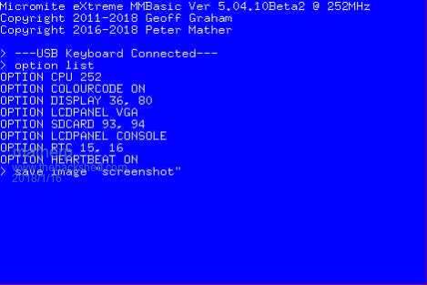

To use the Micromite eXtreme as a standalone computer with a VGA monitor, plug in the VGA connector and set up the display as the console
OPTION LCDPANEL VGA
OPTION LCDPANEL CONSOLE 1,rgb(white),rgb(blue)
This is all that is required to give a nice white on blue display with 36 x 80 resolution and colour coding in the editor

To make things convenient for testing this beta automatically sets the options as listed below. I've also implemented "SAVE IMAGE" for the VGA display and fixed a bug in BLIT for VGA

Nice touch with the vga SAVE IMAGE
