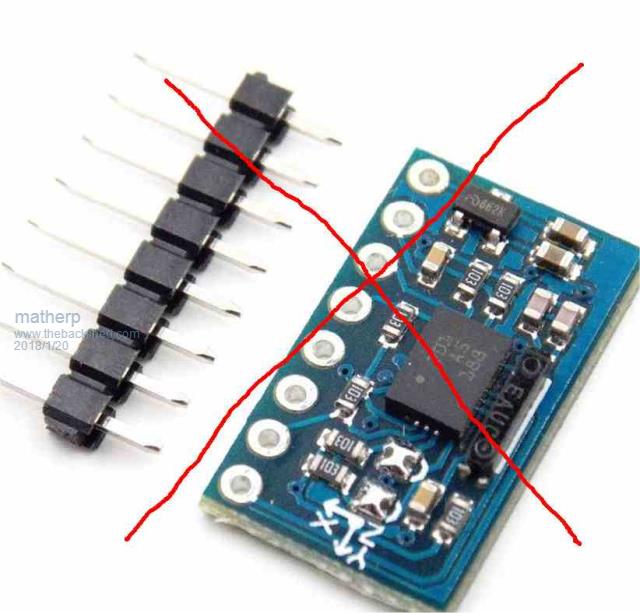

You can buy it off Adafruit but it is expensive

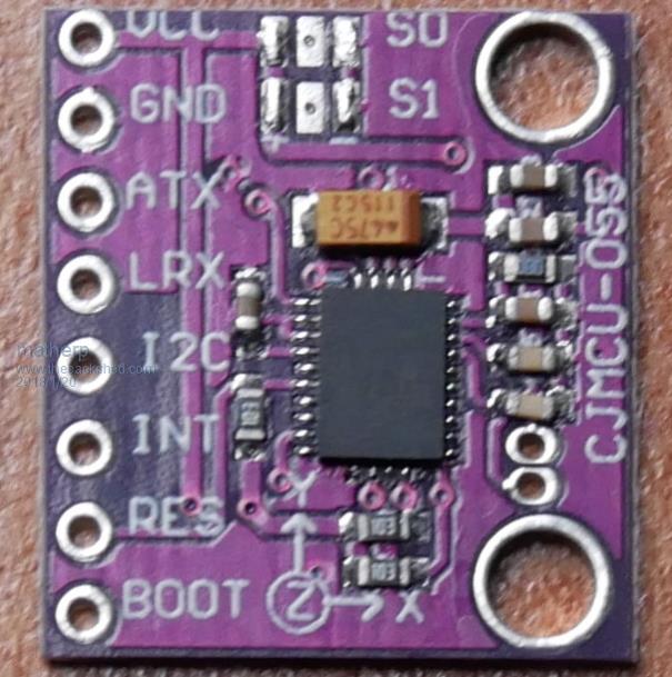

You can also buy two versions from the usual ebay/Alieexpress suppliers. One version should be completely avoided. It cannot be configured for I2C operation. Picture at the bottom.
The one to buy is this one
but you will probably receive one looking like this (three out of three for me)
Note that the zero ohm resistor to the right of the picture is in a different place. As received it shorts out VCC to GND whereas it is supposed to link power from the incoming feed to the chip. The resistor is 0603 size and should be swapped with the capacitor above it. Not easy but very do-able. Note also that links S0 and S1 must be made (connect to - ) which puts the chip into I2C mode.
The vendors supply a 32KHz crystal which can be fitted to provide the BNO055's internal processor with a more accurate clock (by default uses internal RC) but I haven't got this to work on the PCBs supplied ( a simple I2C command is supposed to enable it) so it is probably best omitted. I suspect the load capacitors for the crystal are completely the wrong value.
After these changes are done using the chip is simplicity itself.

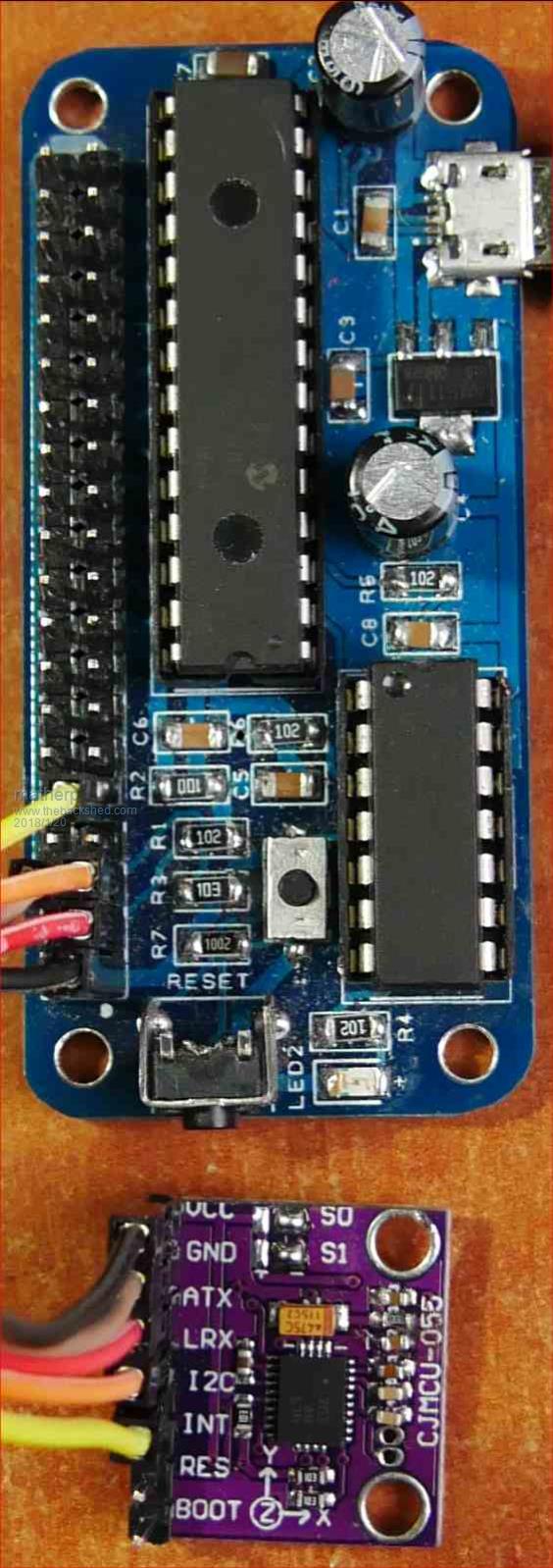

Assuming the wiring is correct the program will then report the absolute orientation of the sensor every half second
Wiring is:
VCC - 3.3V
GND - GND
ATX (also labelled TX-SDA) - Micromite I2C-DATA
LRX (also labelled RX-SCL) - Micromite I2C-CLOCK
I2C (also labelled COM3-I2c_SEL) - GND
The I2C pin selects the part address.

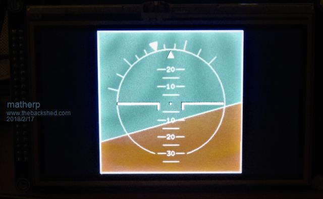

Posts: 11882
Posted: 06:28pm 16 Feb 2018
If you have a BNO055 up and working
and you have a 100 or 144 pin Micromite eXtreme
and you have a 4.3" SSD1963
and you have uploaded the latest firmware.
Then you can play with my Attitude indicator code.
Set up the display using the new buffered driver OPTION LCDPANEL SSD1963_4_16_buff, L, RDpin
and run the code.
The code tests the internal sensor fusion algorithm in the BNO055 and compares it with the open source sensor fusion that I have included in the Micromite firmware. There is no comparison to my mind; the open source firmware running in double precision on the PIC32MZ is much much better and it allows you to tune the sensitivity of the fusion algorithm to optimise for your specific application (see the appendix in the Micromite eXtreme manual) .
You can choose the fusion algorithm in the demo program using the constant "FUSION"
0 = BNO055 internal
1 = Micromite eXtreme Mahony
2 = Micromite eXtreme Madgwick
Update rate on the display is about 18 frames per second
2018-02-17_042145_BNO055-AI.zip
Edited by matherp 2018-02-18
