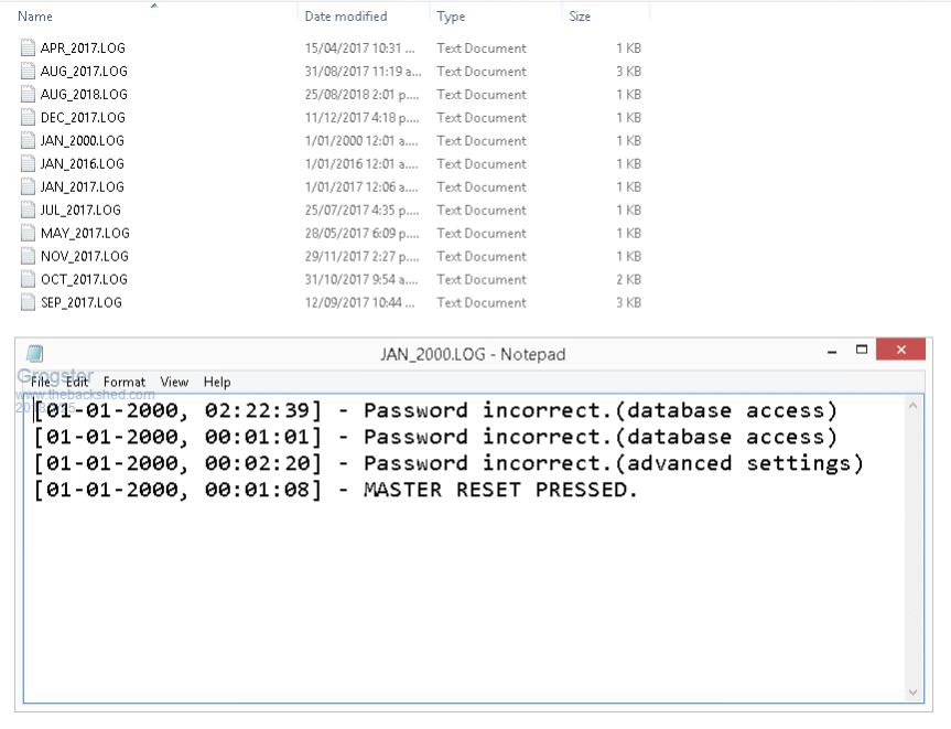

Posts: 10043
Posted: 11:34pm 24 Jan 2018
Hi Phill.
This is what I use in one of my programs, to log any events to a DAILY log file, that changes automatically to a new filename each day.

The beauty of OPEN FOR APPEND, is that if the file exists, it will be appended to. If it does NOT exist, MMBASIC will create it, and start writing to it which makes it nice and simple.
I also have two other subs which are called whenever something unexpected happens(ERRLOG - ErrorsLog), or whenever the user changes anything(SYSLOG - SystemLog). These are MONTHLY logs rather then daily ones, as they don't(or shouldn't!) see as much activity as the daily ones do. T1$ is the data(or message in this case) that you want added to the log, and this is passed to the sub as part of the call to the sub in the normal fashion, then the sub takes total care of logging that message to the current file etc, etc, etc.

EDIT: This is the kind of output files the above two routines produce:
The daily logs are pretty much the same format, but the filename is something like 27JUN17.LOG kind of thing.Edited by Grogster 2018-01-26
