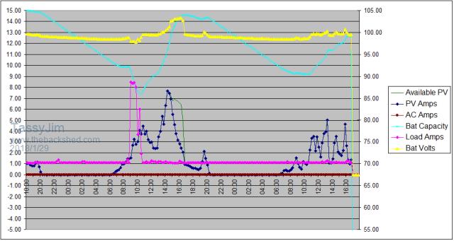

This is the output from a solar powered radio repeater I look after. The readings are done my a micromite and it keeps the last 2 days so I can retrieve at my leisure.
(very cloudy the last 2 days)

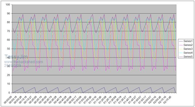

I did a quick and nasty based on your data and found that the cyclic nature of the data produces poor charts for a full day.
This is the first 100 points
And this is the spreadsheet that did it. I left the chart at 100 points for now.
Try pasting another day over the first column. Provided your data stays at fixed length, it should work out OK

Jim, Your spreadsheet graphing is similar to what I end up with but I am not sure how to improve it from there. The probe numbers 0-6 end up in the graph rather than being different pages. The time and level axis are ok.
OA47
Could I save the data in a different format to improve the graphing?Edited by OA47 2018-01-30
