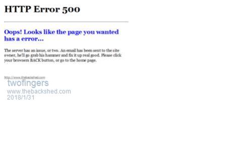

Just a feedback:
I got this a few minutes ago:
I don't know if it means anything ...?

Were you just viewing the doc register? Was it from a link someone had provided in a post?

  Gizmo said   Were you just viewing the doc register? Was it from a link someone had provided in a post?
I don't understand "doc register"?
I tried to open "http://www.thebackshed.com/forum/forum_topics.asp?FID=16&PN=1", AFAIK.

The doc register is here http://www.thebackshed.com/docregister/Browse.asp
I did see an error from one of its pages about the time you reported an error, so thought they may be related.
Ah, that error you did get could have been when the server was backing up. 2am server server time, I think about 5pm in Germany, give or take an hour or two. In the 20 seconds it takes to copy the database, I got 5 error's Its hard to pick a time when traffic is low.

  Gizmo said  I did see an error from one of its pages about the time you reported an error, so thought they may be related.
I guess you're right ... hopefully. I thought, it would be good to report this in case others have a similar issue.
Thanks for your attention!
