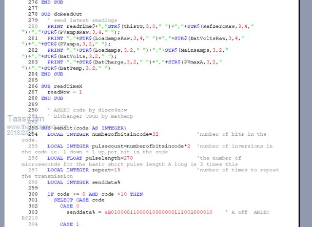

Printing code in colour?
Just printed 13 pages for a school project & it came out B/W.
Didn't actually check my settings, but can MMEdit print colour?
If not is there an easy way to take TBS formatted code to another application & print in colour from there?
Phil.
Posts: 10043
Posted: 04:21am 22 Feb 2018
I'm not Jim, but FILE/SAVE AS RTF works for me.
This outputs a colour RTF file, which I then save as a PDF - job done.

Hi,
I wanted to know this to, but I must be missing something. Didn't find an option to save as an RTF file so I replaced the .bas with .rtf but it still only opened as a normal B&W file in a word processor.
Chopperp
ChopperP
Posts: 10043
Posted: 08:41am 23 Feb 2018
Click FILE menu at the top left of the window, then moved down to 'Save as RTF', and left-click. Follow your nose from there.

Can't see 'Save as RTF'. Ill up date MMEdit & see if it is there
ChopperP
Chopperp
Joined: 03/01/2018
Posts: 1131
Posted: 08:48am 23 Feb 2018
OK, that worked. Thanks

Another question..
Anyway of printing the line numbers?
ChopperP
Posts: 10043
Posted: 09:56am 23 Feb 2018
Pass.
Jim?
Posts: 6606
Posted: 08:31pm 23 Feb 2018
I did experiment with printing line numbers.
I can't remember why I gave up, I think it got too unreliable.
Getting the line-number colours correct is not difficult but the line-wrapping really stuffs up the display.
I don't want to do my own line-wrapping, it would only add more problems.

  TassyJim said   I did experiment with printing line numbers.
Found the Quote button
Thanks Jim
ChopperP

For Jim again
For the CMM V4.5. Noticed that the Alpha-Numeric pin numbers (A0 etc) don't come up in red as do the normal pin numbers.
No real issue.
setpin 9, ain 'analog I/P for solar panel
setpin A0, ain 'Analog I/P for switches
setpin 10, inth, Rain_Gauge 'Rain Gauge Interrupt
setpin 20, INTL, Sw_Press 'Switch press detect
setpin D9, DIN 'Grey Water ON switch
lcd init D2,D3,D4,D5,D6,D7
Chopperp
ChopperP
Chopperp
Joined: 03/01/2018
Posts: 1131
Posted: 12:42am 24 Feb 2018
Just realised that Jim has all numbers come up in Red not only pin numbers so not really applicable to alpha-numeric pin numbers, though that would be good

Posts: 6606
Posted: 01:51am 24 Feb 2018
If it starts with a digit, &H (hex), &B (binary) or &O (octal), it's a number
27BDFFC0
&HAFB1001C
&B01000011000010000000010001001111
&OA6410015
AFB1001C
anything else is a 'word'
It does cause a few issues with CFUNCTIONs
I will add the option to print line numbers to RTF, but you will have to live with any consequences. My main objection is, you loose the ability to copy and paste back into MMEdit because of the pesky line numbers.
