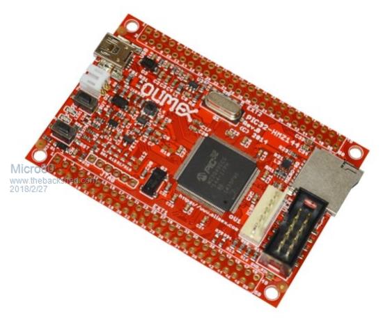

The new version of the board PIC32-HMZ144 is now available with a microcontroller PIC32MZ2048EFG144.

Posts: 11882
Posted: 06:53pm 26 Feb 2018
  Quote  That looks suitable for the MMX MMBasic.
The SDcard won't work as wired
Posts: 4380
Posted: 07:15pm 26 Feb 2018
Thanks, Peter.
Posts: 11882
Posted: 07:36pm 26 Feb 2018
Also the MMBasic I2C is compromised by the way the SDcard is wired and the only thing on the Olimex UEXT port that works is MMX I2C2 on the pins they specify for I2C.
This is the one problem with the Peripheral select mechanism on the PIC MX and MZ chips. It gives flexibility but also means that PCBs developed by different organisations are likely to be incompatible to a greater or lesser degree.

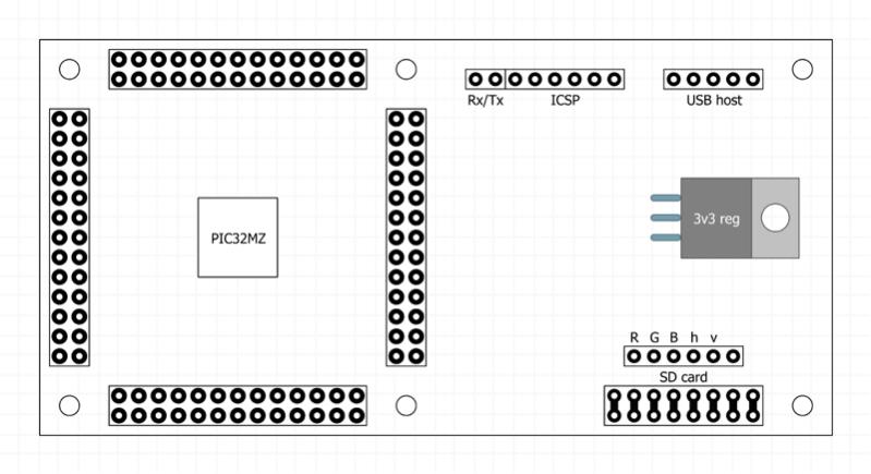

Posts: 2552
Posted: 11:25pm 27 Feb 2018
perhaps what one wants for the MZ may well be:
- a minimal board with just the processor, Vcap, crystal and 3v3 regulator/caps on board (ie, no sockets or LEDs).
- 0.1" header for SD that matches up with the pinout of the cheap SD socket boards available on ebay, in a location where the ebay board can just hang out the side
- 0.1" header for power, ICSP and serial console combined.
- a 0.1" header for VGA output.
- all 100 of the pins brought out to four 2x13 headers arranged around the processor.
- strictly fits within a 100mm x 50mm footprint.
very similar to the snadpic boards that folks were using early on, and that can be sold with just the MZ processor populated. also, that can be posted around the world in a standard envelope.
if limited to 100mm x 50mm, the PCBs can be fabricated in 4 layers for around us$2.50 each.
rob :-)Edited by robert.rozee 2018-03-01

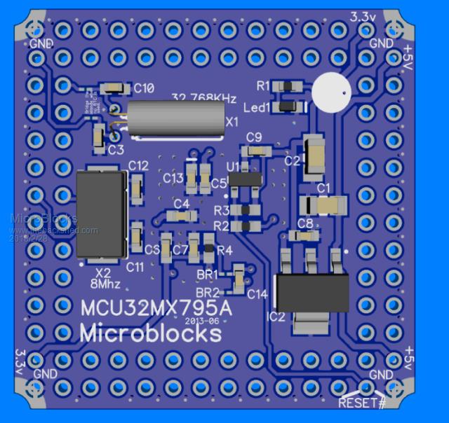

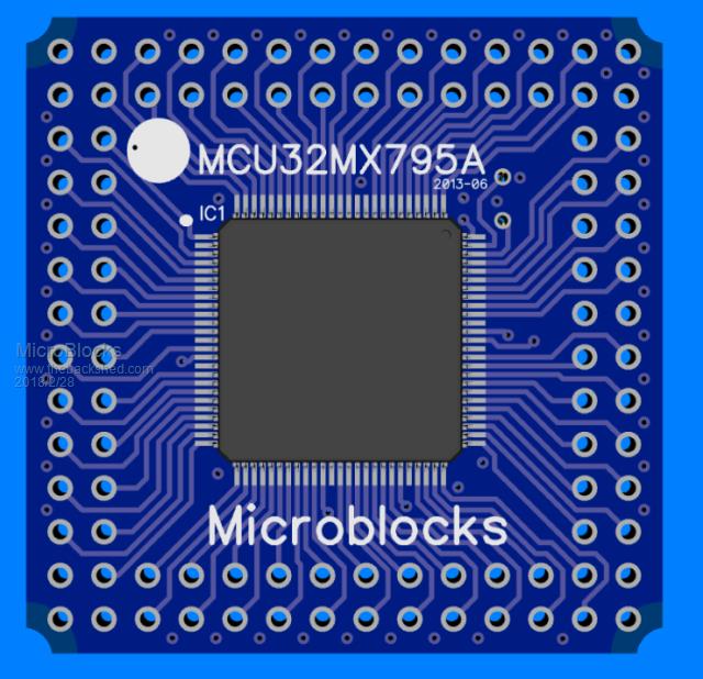

MicroBlocks
Joined: 12/05/2012
Location: Thailand
Posts: 2209
Posted: 05:47am 28 Feb 2018
I have done something similar in 2013 with a qfp-100 chip (MX795) for a customers project.
The absolute minimum can be done on a 37x37mm board, double sided.
with components on both sides.
All 100 pins is not really necessary as a lot of pins are VCC and GND.
Also the OSC pins would not need to be available.
This included a 32Khz crystal for the onboard rtc, a supervisory circuit and a 3.3v power supply.
Bump the board size to 50x50mm and you would have some room for specific pins, but this will probably need a 4 layer as the pins would be in the way. You can even add a 1455 to this to make it even easier to use.
Edited by MicroBlocks 2018-03-01

Posts: 2552
Posted: 01:18pm 28 Feb 2018
all far too complicated. concentrate on the absolute mimimal requirements:
the MZ processor and 3v3 regulators will be the only active components. passives will be filter caps, resistors for the VGA mixing/levels, and a pullup on the reset line. plus the 24MHz (?) clock crystal. the SD 8x2 header leverages off the adapters available on ebay.
NO onboard 1455, NO onboard connectors beyond footprints for 0.1" pin headers. this is a board that can be shipped with just the MZ processor fitted for minimal cost, and the end user can then add whatever they want.
rob :-)

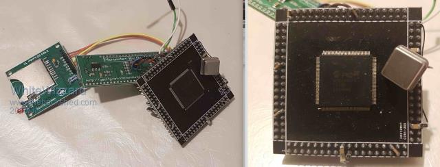

Posts: 2991
Posted: 05:57pm 28 Feb 2018
Here is another early prototype of the MMX144 module!
This one used an E64 PCB (for the power supply), one of Grogster's SD Modules, and a jumper-lead linked VGA lead.
Note on this Break-Out-Board that it was simply an LQFP PCB - I had to solder the decouplers and other minimum components - seen on the right hand side of the photo below
I then added a NunChuck PCB/Module I had lying around (not seen in this photo)
