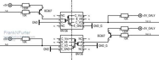

My Flukescope has a optically isolated serial i/o, for which Fluke sell a very expensive USB lead.
I made my own with a FTDI module, and an ir led and sensor, ripped from an old remote control. It works in both directions, I can send commands to the scope and receive plots/readings from the it.
At 9600bps it works very reliably.

  WhiteWizzard said   At what maximum speed do you think an IR approach could work reliably (over a very short distance)? Curious to know if you tried it
I built mine into an old 9 pin d plug housing which plugs into the scope, so the optical distance is probably only 2 to 3mm.
9600 is as fast as my scope will go, so I don't know how much the faster the adaptor could be pushed. In the URL below users have tried 19200, but have experienced problems.
Circuit diagram here: Circuit and discussion

Posted: 08:45am 02 Mar 2018
This circuit worked with up to 115200 bps for me....

Posted: 08:59am 02 Mar 2018
Thanks Frank for that circuit; however, the circuit I need has to have 'physically' separate IR Tx's and Rx's.
My two concerns are 'crosstalk' and speed limit.
Currently unable to try much due to lack of fast IR parts in my spares bin; so more of a theoretical build at the moment!
