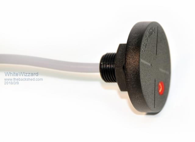

I have a one-wire RFID reader here on my desk connected to a 28pin BackPackv2. This reader can work easily with the MM by using the one-wire protocol built into MMBASIC.
The detection of lack of presence is very easy to accomplish - however, note that the circuit will pull slightly more current when a tag is within range - not a problem though for you by the sound of it.
If you use a 13.56MHz version of the reader then it has an added bonus. IF you place an RF bank-card (in the 'target' wallet) then this behaves as the NFC tag!

Posts: 2991
Posted: 10:40am 09 Mar 2018
The One-Wire RFID reader as mentioned in my previous post. I have not added these to the website ye; however, I do have both 125KHz and 13.56MHz versions immediately available.
Will post a code snippet next to show ease of use

Posts: 2991
Posted: 10:51pm 09 Mar 2018
Forgot to mention that the reader pictured above has a diameter of approx 35mm; and a max read range of 4cm
And low cost 13.56MHz NFC 'stickers' can be used on other 'bait' items - however, only one tag can be read at a time.
