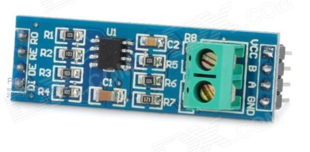

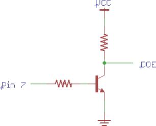

Hi All,
Have a few of these modules.
Presume I can't directly connect them straight to a 28 pin chip.
[Quote=MicroMite Manual]
The 'DE' option in the OPEN comspec$ for COM1: specifies that the Data output Enable (ENABLE) signal for
the IEEE 485 protocol will be generated. This signal will appear on pin 7 on the 28-pin chip and is normally
high. Just before a byte is transmitted this output will go low and when the byte has finished transmission the
output will go high again. Note that this polarity is the opposite of that used in the Maximite family and an
inverter is normally required to drive the DE input of an IEEE 485 transceiver.
[/quote]
Is it at all possible to invert this signal in software to avoid the additional device?
I know Geoff wrote a C-Function to manipulate the state of certain pins.
Is that relevant in this case?
Would be nice if the MAX485 could just be directly connected.
Phil.
Edit:- ChangePin is the embedded C-Function I was thinking of.
[Quote]7 LATINV Invert digital output[/quote]Edited by Phil23 2018-03-25
Posts: 3368
Posted: 02:41am 25 Mar 2018
No, unfortunately you are stuck. The inverted polarity of the DE pin is a 'feature' of the PIC32 hardware that MMBasic uses and annoyingly cannot be changed.
Using the ChangePin CFunction also will not help. The LATINV parameter will flip a pin into its opposite state (ie, a hi to a lo). It does not invert the data.
Geoff

Posted: 04:05am 25 Mar 2018
These are easy to use and require not much space:
http://www.onsemi.com/PowerSolutions/product.do?id=MC74VHC1GT04
Quazee137
Joined: 07/08/2016
Posts: 603
Posted: 09:53am 25 Mar 2018
@MicroBlock I agree those are great.
but if you don't have and need to test now go old school
Quazee
Phil23
Joined: 27/03/2016
Posts: 1667

Posted: 11:42pm 26 Mar 2018
  Phil23 said  would it be possible to do something like this with an embedded C-function that allows another pin to follow Pin 7, but in an inverted state?
Phil.
Phil,
If you have 2 pins spare you could handle this in your code without the need for a C-Function. Assign one pin as a Digital Input and connect it to the DE pin (7). Assign the second pin as a Digital Output. In your code add an Interrupt on the Input pin activated on both Hi and Lo transitions, and in the interrupt handler just set the output pin to the opposite polarity of the input one - so it becomes the DE inverted pin to connect to your RS-485 module.
It would add a very small delay to the DE signal transitions, not sure it this might cause any problems at the start of transmission. Maybe you would need to transmit a dummy character at the start of the real data just in case the first character gets missed due to any DE latency.
Cheers,
Another Phil.
Phil23
Joined: 27/03/2016
Posts: 1667
Posted: 12:30am 27 Mar 2018
Thanks,
Also some alternate Modules arrived yesterday.
These,
https://www.aliexpress.com/item/TTL-turn-RS485-module-485-to-serial-UART-level-mutual-conversion-hardware-automatic-flow -control/32709226383.html?spm=a2g0s.9042311.0.0.0pGBWV
They might be easier to live with as they handle the flow control themselves.
