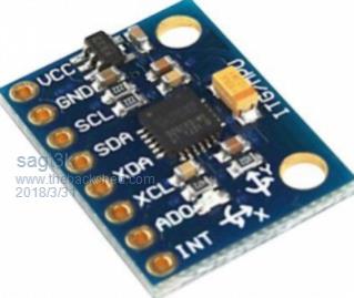

Hi Geoff
I'm tryng new firmware with my board with pic32 mx 64pin connected via USB and a MPU6050 via I2C at 400khz and res pullup 10k.
I view strong delays and possible loss ofconnections with I2C when I use USB. While if I connect a usb/uart as CP2102 in console the communication is fluid.
Where could the problem?

sagt3k
Joined: 01/02/2015
Location: Italy
Posts: 313
Posted: 01:05pm 30 Mar 2018
Hi Geoff
I tried different combination.
If I connect with usb standard console and I use i2c, after a lot a data at 115kbaud ..afetr 10 sec ...and I use I2c ...the var MM.I2C return 2.
Same circuit, same code, same slave i2c modules but I use a cp2102 connected on console same code same baudrate it works several minutes without problems.
Now I try changing with old firmware...
Some idea?
ThanksEdited by sagt3k 2018-03-31

sagt3k
Joined: 01/02/2015
Location: Italy
Posts: 313
Posted: 05:32pm 30 Mar 2018
HI Geoff
Then, tried with an old version 5.4 same problem of 5.4.9, with simple board and complex board and this is the output after 264sec of execution (in this example) with Micro 64MX+USB, block in random time. I deduce, and I do not know how using usb and i2c happens the problem.
With CP2102 in console the code it works indefinitely, same code, same module.

This is the module (that has its resistances in pullup):
This is the code original by TassyJim:

sagt3k
Joined: 01/02/2015
Location: Italy
Posts: 313
Posted: 07:47pm 30 Mar 2018
Hi Geoff
Then I set autorun, then I tried to connect my board with other configuration and made several tests:
- PIC32USB + USB battery power... I see the led RUN for many times OK
- PIC32USB on PClinux + minicom ... I see the led RUN for 5/10min , after it stops!!
- PIC32USB on ARMlinux + minicom... I see the led RUN after 5/10minutes it stops!!
- PIC32USB on WIN 10 + PUTTY ... I see the led RUN after 2/3minutes it stops!!
- PIC32USB on WIN 7 + PUTTY ... I see the led RUN after 2/3minutes it stops!!
- PIC32USB on WIN XP + PUTTY ... I see the led RUN after 5minutes it stops!!
PIC32 configuration always with MPU6050 + I2C and USB connection
With USB battery power, I connect a PIC32 with an ESP8266 with ESPlink firmware and with my Smartphone with a terminal emulator for 30min many many times.
After I reset the board and retry with this configuration OK !!!
Could it be a USB problem?
Antonio
Posts: 3368
Posted: 09:33pm 30 Mar 2018
The fact that it works on battery power indicates that it is a power supply issue.
Are you powering your board via the USB connector? That has caused many problems in the past with many people. A USB power supply is often noisy and what is confusing is that the Micromite appears to be working but suffers from intermittent and strange errors. Using a proper power supply (not USB) is the answer.
If you can, switch to a separate lab quality power supply.Edited by Geoffg 2018-04-01

I changed it to close the I2C after each read and stop when the timeout occurs.
It also confirms that the error occurs with the READ, not the WRITE.
The reading before the failed one takes the usual time. ie it is not failing gradually.
Changing the delay between reads from 25 to 250mS made no difference.
Adding a few extra delays between various operations made no difference.
I don't have any devices connected to the Explore64 other than the MPU6050.
It is powered from a separate 5V supply and the same supply for USB and Serial tests.
Using TeraTerm on Windows for all tests.
Using the USB connection, the timeout error can occur anytime, up to 250 seconds in some cases.
Sometimes (but not always), if I try to restart the program immediately, the timeout error occurs immediately. Removing power to the MPU6050 clears the error. So (I think)does waiting for a while.
No failures (yet) when using the serial converter for the console.
I haven't tried any other I2C devices to see if it's just the MPU6050 that has issues.
