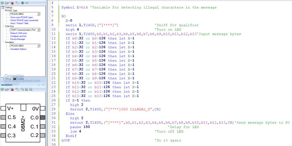

Yes, I still use PICAXE from time to time for simple stuff, but when I went to change a program for a data-filter I use an 08M2 for, the PICAXE program won't let me do it.
It keeps complaining about an IF without matching ENDIF, but from what I can see, I HAVE the endif in the right place. It is complaining about line 25 having that problem, but it does not care at all about the other 12 IF's above it needing an ENDIF....
Do any of the members here who still work with PICAXE know where I am wrong?
....I've got WAY to used to using MMBASIC, and I think I have forgotten some of my PICAXE-BASIC.

You probably need to terminate each of the 14 or so " IF b0....etc" lines with an endif .
Hans
Posts: 10043
Posted: 07:42am 27 Mar 2018
You're right, I did have to!
As they are all single-line IF/THEN's, I did not expect they would need endif's of their own....
Oh well. Code passes syntax test now. Will now see if it works.

Yes, in my case, the PICAXE 08M2 is being used as a data-filter on the output of a 'Dumb' RF receiver. When the data is not valid, the receiver just outputs white-noise, which must be filtered out for reliable message reception.
The code is single-purpose only, and it just waits for valid data using the PICAXE's useful SERIN and qualifier idea. Once it has sent a message packet to the main system, it just sits there forever waiting on another one to forward.
Rogue characters(000-031 and 128-255 decimal) were making it past the original filter code every now and again, and confusing the hell out of the main system. Hence my adding the IF/THEN's to test each of the 13 bytes as valid first.

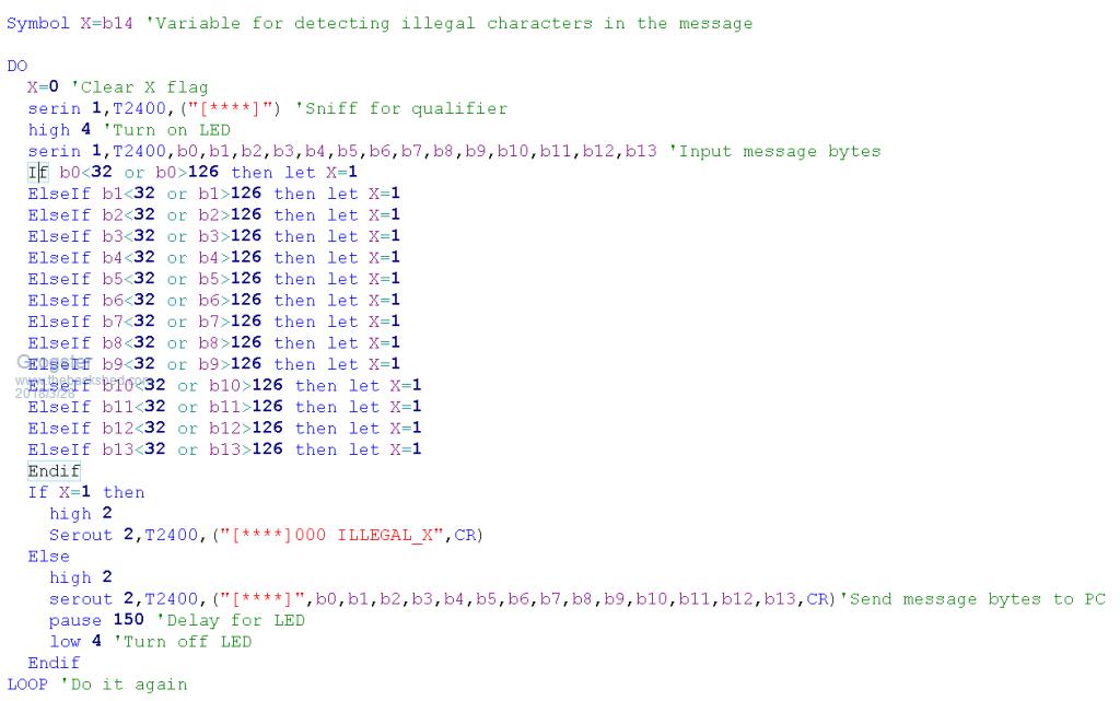

Speed may not matter, but if you put ":" after each "then" and change the "IF"s after the first one to ELSEIF and put an "ENDIF" at the end, then the comparisons will cease after the first invalid one is found (no ENDIF per line needed).
Posts: 10043
Posted: 11:34pm 27 Mar 2018
Do you mean like this?
This compiles fine too.Edited by Grogster 2018-03-29

Posts: 3881
Posted: 01:00pm 28 Mar 2018
  Grogster said   Do you mean like this?
Right. I thought from what you had said earlier that the colons (":") would be needed, but it looks better without, and if it compiles, it should work.
