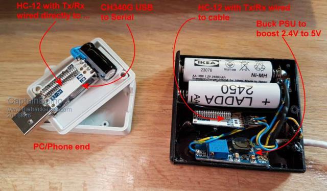

the problem with using serial as a bus is the conflict of signals. This can be solved with a mixture of open collector/drain outputs and pull-ups.
Using a radio link provides an open medium that can support many devices without any hassle caused by conflicts. I developed an addressed serial network using HC-12 433MHz links, but any would do.
fruitoftheshed.com/MMBasic.Short-range-radio-network-not-WiFi-SLAVE-module-Uses-cheapie-433MHz-modules-or-HC-12.ashx
this has a master + upto 998 (as written) slaves with discovery and multiple message types/formats - the radio traffic is encrypted. It's not a heavy duty encryption but stops basic snooping. I had RC4 but the smaller micromites could struggle to keep up in the 1.5 second window response times.

CaptainBoing
Joined: 07/09/2016
Posts: 2171
Posted: 02:48pm 04 Apr 2018
hmmm... busted link. Dunno what happened there.
http://fruitoftheshed.com/MMBasic.Short-range-radio-network-not-WiFi-SLAVE-module-Uses-cheapie-433MHz-modules-or-HC-12.a shx?HL=radio

  RyanHammond said
At this point the wireless is pretty much out of my league... The thought of using wireless is however very interesting and I will want to pursue that in the future.
Please don't be put-off. HC-12s contain a processor that does all the tedious mucking about.
This really is so easy you'll wonder why you never played before. All you do is have two radio modules... HC-11 or HC-12, say. You take the TX/RX at one end into the correct pins on the module and do the same at the other end. Whatever goes in at either end pops out at the other - it really is that simple. The only gotchas are getting the tx/rx pins the right way round (they are relevant to the whatever you are looking at right at the moment, so the Tx on the micromite is an output so it goes to the Rx pin on the radio module) and getting the baud rate for the distance. I can't speak for HC-11 but HC-12s have a mode on them that will do a mile in open field tests(!) but not at 115K... they will do it at 9600 though and if the area is noisy or lots of walls, just drop the speed. Another might be the channel but they should all come factory fitted to channel 0 (upto ch127 I think) If you projects that want to use wireless but not with each other, you can easily switch the relevant pairs onto another channel.
Here is a picture of my wireless link that I knocked together in an hour for access to awkward placed devices. The bit on the left goes into a PC or phone, the bit on the right plugs into any number of micromite devices I have. It is four components and some wires. Told you it was easy. The radio links just remove the need for wires. Now, shoo!, off to ebay with you!
I use this for making my life easier when servicing units in awkward places - for instance, I have about 100 units for Snooker-hall light control (not all at the same place). They are all hidden in the false ceilings so instead of me wobbling about on top of some steps with my laptop, I plug this in and work in comfort with my feet on the ground. When I am done, I unplug and move on to the next. I can even plug the PC end into my phone with a bus master adapter and talk to them from my S7 - great for just snagging some logs etc...
Edited by CaptainBoing 2018-04-07
