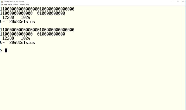

Here is what I get returned from approx 18deg room temp. (the 2nd Row shows the Thermocouple TIP 14 bits and the Internal `cold' junction 12 bit temperature both in binary)
If I warm up the thermocouple it does change but non-sensibly, The fault bit is always 0 unless I short the thermocouple to GND then I can see it change.
Anyway I would appreciate if someone can see what is wrong or provide a snippet of complete working code for me to try on a 28 pin MM.
I have now tried 3 different Max PCBs and about 5 thermocouples of various shapes but all are K-Type.

Posts: 2981
Posted: 11:27am 07 Apr 2018
Hi all,
I have tried various speeds, hence 10k where comment says 100k. ..100k was my first attempt!i also tried 1M. I also tried all four modes of SPI operation.
I also tried without the delays on CS.. I added these as the data sheet mentions a delay (not near my pc at the moment).
I agree it appears to be miscommunication but I now feel that Jim is on the right track re variable type..
I don’t know much about variable types.. I need to do a bit of reading of the manual, maybe an undefined variable can’t hold a 32bit value..
Will try again with different variable types tomorrow..
MickEdited by bigmik 2018-04-08

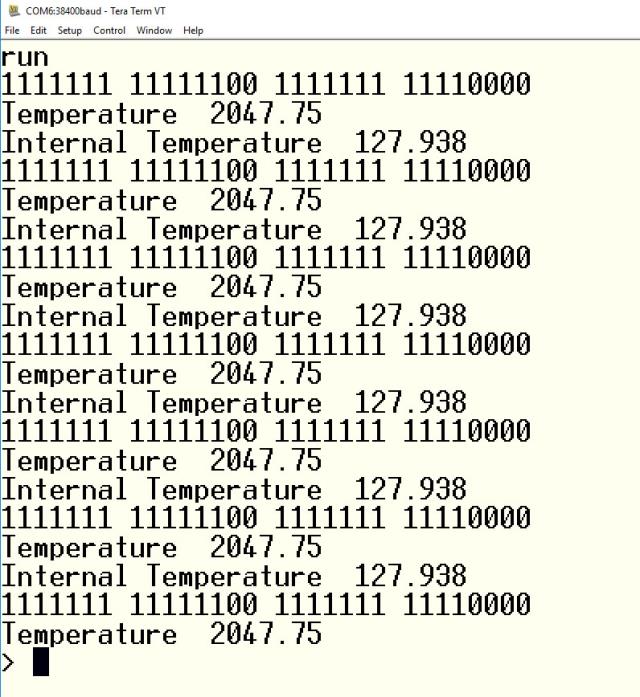

Posts: 2981
Posted: 11:40pm 09 Apr 2018
Hi Jman,
Ok I tried your code but similarly I get incorrect readings (basically the same as my 32 bit SPI code)
I had to change your code to suit my CS of pin(15) and also you used a variable called ERROR which gave me a syntax error so I changed that to ERROR1 I also added a print routine to show what all four SPI reads are and a 2 second delay to see what I received.
Here is the result I see after those changes
Here is the code with my Alterations

Something is seriously wrong here.. It surely shouldnt be so difficult..
I tried changing all 4 modes of SPI (0-3) and whilst the results change they are still nonsense. I have tried 4 or 5 K-Types (2 different styles) that work with a cheap temp meter I bought and 3 different MAX31855 modules although they are all the same type (I had to cut the GND from the Thermocouple itself)..
I will have to go back to basics, I will remove the chip from the test board and breadboard the circuit as the Datasheet shows..
Thank you all for your help..

If err <> 0 Then
Print "Thermocouple Error"
Pause 1000
EndIf
TempMSB = Temp(0)*16
TempLSB = ShiftR(Temp(1),4)
TempDP = (ShiftR(Temp(1),2) And &B00000011) * .25
Temperature = TempMSB + TempLSB + TempDP
Print "Temperature ";Temperature
TempIntMSB = Temp(2)
TempIntLSB = ShiftR(Temp(3),4)
TempIntDP = TempintLSB * 0.0625
TempInt = TempIntMSB + TempIntDP
Print "Internal Temperature ";TempInt
GoTo Start
