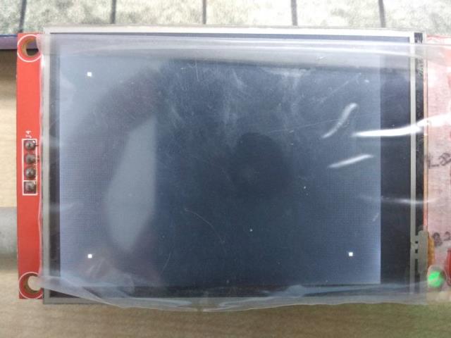

Hi All,
I am using MM+ with ILI9341 LCD panel.
My TFT able to display everything, but unable to trace any touch on the screen. This comes out when I write 'OPTION LIST'
OPTION LCDPANEL ILI9341, LANDSCAPE, 2, 23, 29
OPTION TOUCH 1, 3
When I write 'GUI CALIBRATE', something is not right. If I touch target without any hold, sometimes incorrect calibration, sometimes no errors (as shown below)
Warning: Inaccurate calibration
Deviation X = -106, Y = 0 (pixels)
Done. No errors
Deviation X = -2147483648, Y = 0 (pixels)
However, when I touch the target AND HOLD, there is error as shown below.
Error: Touch hardware failure
So, I decided to just touching the target without any hold. Once there is no error, I proceed with 'GUI TEST TOUCH' command. But then, there is no white dot appeared on the display.
How should I fix this?

I am sorry but I guess my TFT is just fine, the problem might comes from the Micromite itself.
I tried to connect that Micromite with another TFT, the same problem still occurs
miyek.ard
Joined: 31/03/2018
Location: Malaysia
Posts: 24
Posted: 03:19am 11 Apr 2018
SOME UPDATE!
I write 'GUI CALIBRATE' and then touch the targets, the result is
Done. No errors
Deviation X = 0, Y = 0 (pixels)
Then I write 'GUI TEST TOUCH'. When I randomly touch the screen, somehow there are 3 dots appeared.

Rather weird, It has definitely calibrated OK, I usually just drag my finger nail across the screen and it draws a trace. I take it the plastic is to stop the camera flash reflecting. Other than that maybe Matherp can help, or send a PM to WhiteWizzard.

I drag my finger nail across the screen but no trace drawn on the screen. Is there any other solution?

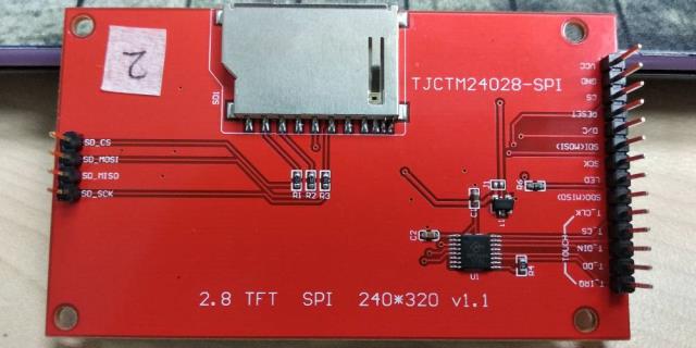

Are you sure your display has the TOUCH function. It is possible to buy displays without this function. They still have the touch pins on the back but U1 is missing from the board.

I have U1 on my TFT board.
I did continuity test using multimeter and all connection are just fine. So I guess there is no soldering issues?
Eventho I remove the plastic film from the screen, the touch still cannot be traced.
