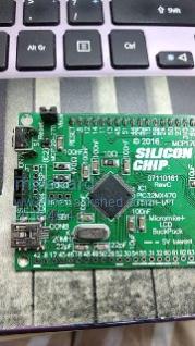

Hi peeps.
I had a Micromite Plus LCD Backpack running perfectly without any bugs or errors. Initially I powered up the board using USB console at CON8, so I fit the jumper JP1.
Then I changed the power connection from CON8 to CON1 (without removing the CON8 connection). But I forgot to remove the JP1! After some times running the MM+, the board cannot be connected to the PC anymore. It keep connect and disconnect itself from the PC. Same thing happen for any connection I made.
Is it because of the JP1? How should I address this problem?

I want to clarify that the module can be connected to the PC. Tera Term able to trace the serial port. However, when I connect the Tera Term, the connection started being unstable

  Quote  When you say "I changed the CON8 power connection to CON1", are you connecting ONLY 5V and GND to CON1?
Tx and Rx also connected. Refer image below.
  Quote  how are you connecting the Micromite to the PC in this configuration?
Initially, I use CON8 as power and I fit JP1. Then, I changed to CON1 as power and CON8 for transferring data. The problem is I forgot to remove JP1 for my second connection!

From your answer above, I understand you are using a serial to USB module on CON1 and using it to supply power to the Micromite? Is this correct?
If this is correct, can you tell us what voltage is being supplied by the serial to USB module?
Have you confirmed that the USB port on your PC and the cable you use to connect to the Micromite are both good and work correctly with some other device?
From your descriptions above, it sounds like you may have damaged either the Rx or Tx drivers on the serial to USB module or the Console Rx or Tx on the Micromite.
As a further test, can you connect 5volts and ground to CON1 and ensure NO connection to the Tx and Rx pins, then with JP1 in, connect a known good USB cable to a known good USB port on your PC. Does this work? Does the PC recognise the USB connection to the Micromite?
Just as an observation, if you had 5v connected on CON1 and jumper J1 in and 5v coming from the USB CON8, this should not cause any major damage with both voltages being the same, so something else must be causing problems. Also, as the Console and USB inputs to the Micromite use seperate pins, it is unlikely that both would be damaged.
