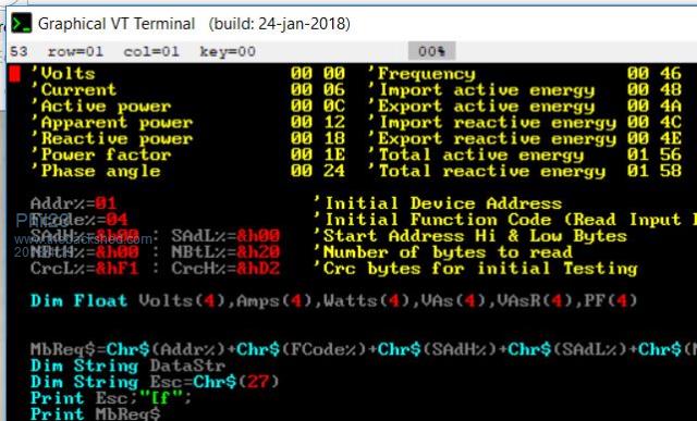

Have always noticed that the font colours in the editor don't work real well against the black background in Teraterm, but they appear fine in GfxTerm.
Variables in particular.
They are Grey in GfxTerm, invisible in Teraterm & white in the DOS editor.
Do I have something configured wrong in Teraterm.
Phil.

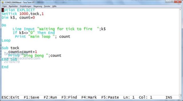

Hmm, why has the background color in Tera Term to be black?
The lone and ...

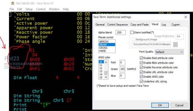

the problem is that teraterm does not handle colour attributes in exactly the way that the mmbasic editor expects. see the below screen captures from both teraterm and gfxterm:
teraterm maps both dim and normal brightness text as bright, except for black that maps as always dim. this means that 'normal black' appears as black-on-black (ie, not visible). whereas GFXterm maps dim and normal brightness to a 16-colour palette - where 'normal black' appears as grey. this follows the pattern of various sources on the web.
unfortunately the mmbasic editor uses 'normal black' quite extensively when operating in colour coding mode (OPTION COLOURCODE ON). as a result, out-of-the-box teraterm has problems if the user turns on colour coding.
rather than inverting the colours in teraterm, a better solution may be for someone to work out how to configure teraterm to use a different pallete - or for the mmbasic editor to not use 'normal black' for readable text.
rob :-)Edited by robert.rozee 2018-04-20

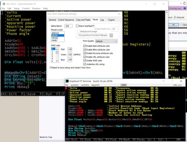

  TassyJim said   You can configure all the colours in TeraTerm, mot just the background.
I think it's under Setup/additional Settings/Visual
Thanks Jim,
I just had a quick look in there,
Presume I'd need to know the ANSI code of the colour used for variable names that are missing on the left.
Phil.
Edit:- The ANSI codes seen above only go from 0 to 15, so 16 Colour palette it seems.
Edited by Phil23 2018-04-20
Phil23
Joined: 27/03/2016
Posts: 1667
Posted: 10:45am 19 Apr 2018
This works,
ANSI 0 defaults to 0,0,0; black.
Change it to 128 & it's visible.
Phil.
