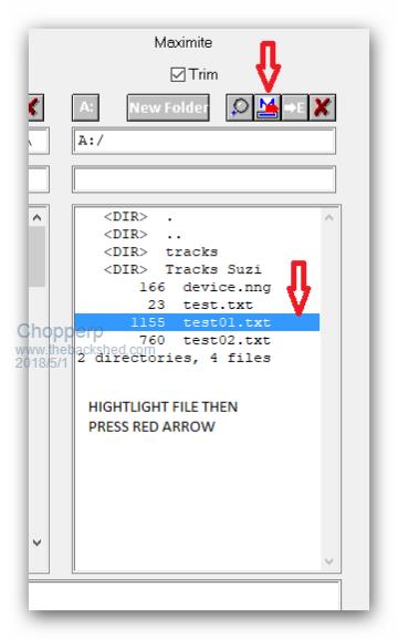

Chopperp
Joined: 03/01/2018
Posts: 1131
Posted: 06:06am 01 May 2018
What I am doing right now testing SD cards is in the right column of MM File Master, highlight the appropriate file (Click on the file you want to transfer), then click the red arrow icon above it (2 over from New Folder). A windows directory comes up & then save from there.Edited by Chopperp 2018-05-02

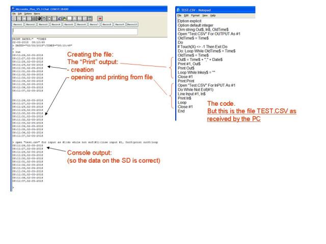

Andrew_G
Joined: 18/10/2016
Posts: 904
Posted: 06:39am 01 May 2018
Hi Chopper - yep that is what I am doing.
If I do this from the console:
"open "test2.csv" for input as #1:do while not eof(#1):line input #1, Out$:print out$:loop" - I get the correct listing of the data file.
If I open MM file manager and use the file viewer (the icon to the left of the red arrow) all it contains is a listing of the program.
When I transfer the file (via the red arrow) the one that gets to the PC is is just a listing of the program (smaller than the data file of the same name)
If I put the SD card in the PC it is the correct data file.
(I'm out for a couple of hours so a lack of response is not a lack of interest)
Andrew

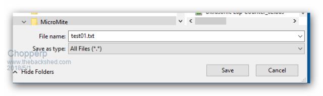

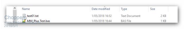

Joined: 03/01/2018
Posts: 1131
Posted: 07:22am 01 May 2018
Ah, that's what that button is for. That's not working for me either for transfer.
Don't select the Quickview button.
Just select the file & click the red arrow icon. (Image 1)
This will transfer the file to the directory you select. (Image 2)
You will need to open the PC directory to get the file. (Image 3)

Andrew_G
Joined: 18/10/2016
Posts: 904
Posted: 12:46am 02 May 2018
I have just re-tried TeraTerm and it is doing the same thing. A file on the SD card that appears to be in text/csv format when transferred (via XModem) appears on the PC as a text listing of the program in the MM+ memory.
So it is not a MMEdit thing?
Andrew
