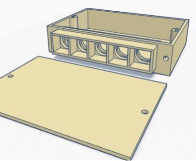

Good topic!

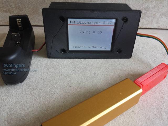

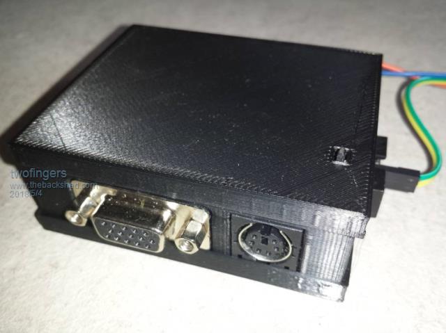

I bought my Anycubic I3 Mega half a year ago for 250 € and I am satisfied. I especially like the UltraBase (special glass plate) and the stable frame. Cons: the loud fans (I will replace).
I print my enclosure for the Mites with PLA.
It is important to find the right filament (~ 17 € per kg). I think the print area - for my purposes - should have at least 200x200mm.
Enclosure for the Duinomite Mini:
Enclosure for Micks BP170 and a CP2102
I design my 3D models with Tinkercad (online). Slicer: Cura.
Michael

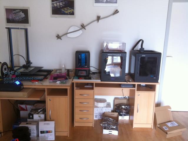

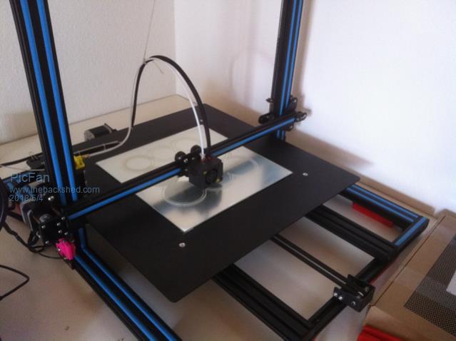

This is my printer park. If you want a plug and play device, there is only the Zortrax M200 for me. If your parts are larger than 200x200mm then I would like to give you the Creality CR-10S5, but you have to deal with that a bit already. Then there is the question which material for which temperature ranges you would like to use?
Greetings from Tyrol!
Wolfgang
The "BIG" CR-10 (500x500x500mm, Printspace)

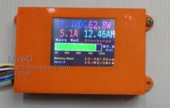

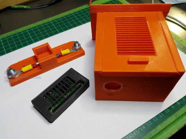

You have fiddle and experiment a bit IMHO BUT the results when you get to know your equipment and software can be quite rewarding.
I also print with PLA which costs ~ AUD35 1kg(Araurum ) Its worth buying good quality.
Selection of Projects: The longest was the Stevenson Shield ~ 18hrs, typicaly small
parts and enclosures would be say 3 - 7 hrs. I run my printer stand alone (it has internal SD card) recently I put it on my UPS , as ther is nothing more frustrating where a brownout ruins a print.
Caravan Meter enclosure (MX170 2.4"LCD)
Battery sensor mount , Pi Zero enclosure, Stevenson Shield for Weather Sensors
I use TinkerCad for design and KISSlicer here

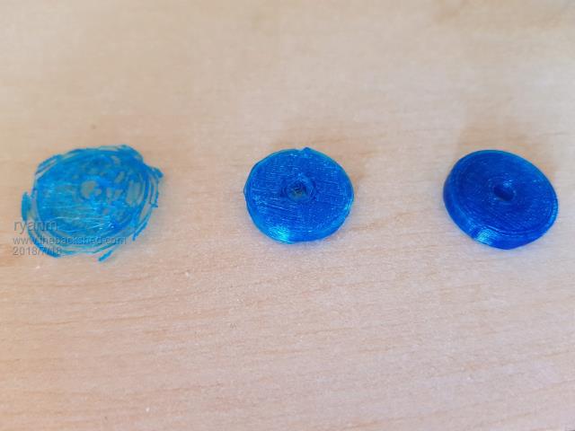

Don't know if you're still watching this one Grogster, but I just got a Geeetech i3 based off the recommendations in this thread. Dynamite little unit, super easy to get going with the PLA that came with it. Swapped over to PET today (stuff coke bottles are made from.) Had a bit of trouble getting it worked out, but now I'm making parts that can take a hammer blow and laugh it off.
