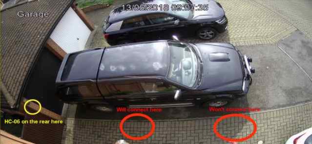

  Phil23 said   You'd probably find the HC-06 range really limited.
Have used them here to connect to my Spa initially; once I got past 10 outside it was game over & It wouldn't connect from outside to the lounge room which is about 5m thru a couple of walls.
same here. I have an HC-06 on my garage controller, granted, it is behind a brick pillar but you have to walk up to the door and be no more that 6 or 7 feet to guarantee connection from a phone (where the app is). Once established, the link seems a bit more forgiving and so long as you don't go indoors or round the corner it seems to stay established to about 30 feet or so. Coverage inside the garage and to the rear is better even though there is a lot of metalwork inside.
