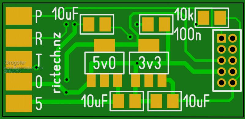

Time for some sleep, but this is what I have so far:
This board contains a MM2 and an SOIC H-bridge to drive the motor. Input can be AC or DC. Current PCB size is 31mm x 13mm - same width as an HC-12 module, and a little shorter. PWM 1A connects to the P pad(for engine lights, perhaps?), and PWM 2A/2B are the motor control PWM channels. The 2x4 pin-header holes are for the ICSP and console connections, although, you would not install the pin-header, as it would make the module to thick. We need to keep a low-profile.
I am thinking about making that 2x4 header into an edge-connector rather then pin-header. This will allow me to shave a few more mm off the length of the PCB, and then you just plug the PCB into an edge-connector socket for programming.
To be continued. Right now, I need sleep.
Posts: 10043
Posted: 12:54am 15 May 2018
Have changed the 2.54mm pin header, for a 1.27mm female header. These are half the size(obviously), and are only 4mm tall, so they should not get in the way, and this allows easy mounting on a matching jig for programming and testing.
Size is now 27mm x 13mm, so I have shaved 4mm off the length.
Passives are 0805, regulators are SOT-89, MM2 is SSOP, H-bridge is SOIC.
12v power can be supplied via the header, really just to make programming easy, as that allows the on-board regulators to do their thing without any kind of back-feeding issues. I will keep looking for ways to optimize this layout, as I want to get it as small as possible. I think this is pretty close to as small as we can get it though, without going to four-layer. I'm not prepared to go four-layer just to shave a couple more mm off the size, as four-layer boards are four times the price of double-layer.

Posted: 02:14am 15 May 2018
If you put the cap (100n next to the mm) to the other side you might be able to shave off another millimeter or two. :)
Posts: 10043
Posted: 03:24am 15 May 2018
Nice one, thanks.
