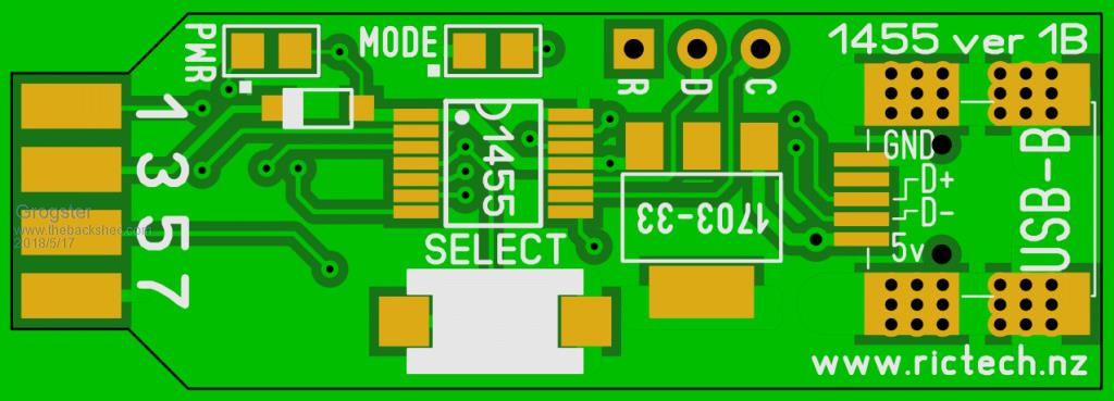

I found that more and more these days, I need to have both the ICSP pins AND the console pins at the ready. To ease my stress level having to keep reconnecting things between ICSP mode and console mode, I decided to build a special programmer/debugger tool.
The board is 43mm x 15mm so quite small. The 1455 chip is SSOP. All passives are 0805, regulator is SOT-223. It was after I ordered them, that I thought that the SOD-123 diode on the 3v3 line is probably pointless, as the 3v3 pin will actually be around 2v7. The idea was to stop an externally powered circuit from coming back into the output of the programmer regulator. The 1455 chip does not care about the 3v3 line like the Microchip PK3 does, so I guess it does not matter that much.

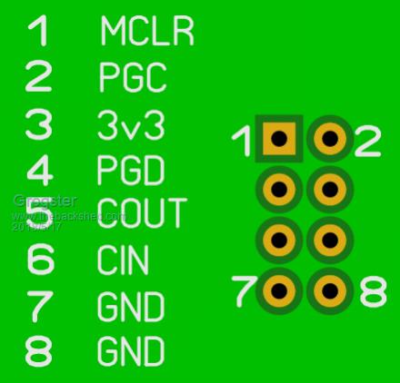

The business end of the unit has a 2x4 female header mounted with the board in the middle of the two rows of pins. This could be male, and the boards female if preferred, this is just how I do it. It is a standard 2.54mm 2x4 header with the following pinout:

There is a double row of male header soldered to the end of the main board with the board between them & they plug into female headers on the MM board which has the ICSP & Console pins wired up as per the "Business End". Is that correct?

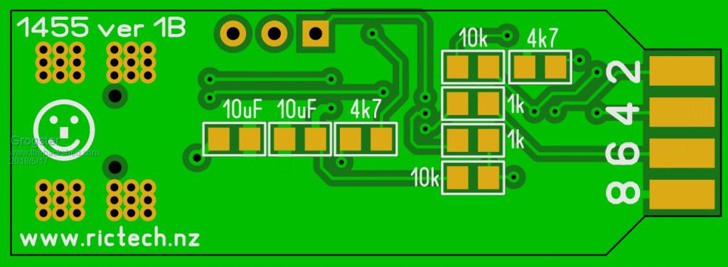

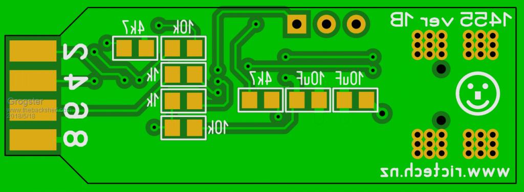

Also I: Is it possible for your bottom board photos be flipped / rotated end to end. It may make it easier for me to mentally line up the top & bottom components & tracks etc.

I do it with a female(what?!) header on the unit, and male pins on the project, but you can have it with male pins on the unit, and female header on the project - up to you.
The board images are flipped horizontally, as that is how you would look at the board, if you turned it over horizontally. How about an image showing both layers:

Not sure with both images together.

Here are both images just for you.

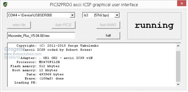

To upload a HEX to a PIC32 chip, you use the 1455 as the programming tool, and PIC32PROG.EXE, which is a command-line programmer co-developed by robert.rozee and Serge Vakulenko. Rob write a nice little GUI for the front-end, so you can do it all with just a few mouse clicks:
The procedure is:
1) Connect the 1455 to your Micromite chip
2) Press SELECT button to put the 1455 into ICSP programmer mode(LED lights)
3) Run pic32prog GUI, select HEX file and COM port that the 1455 is on
4) Click "Flash PIC32"
That's all there is to it.
"Flash NANO" is an option for the original concept that used an Arduino Nano as the basis of the programmer. You could click this button to load the code into the NANO module to make the programmer work. You can safely ignore that button, as we don't use it anymore.Edited by Grogster 2018-05-19

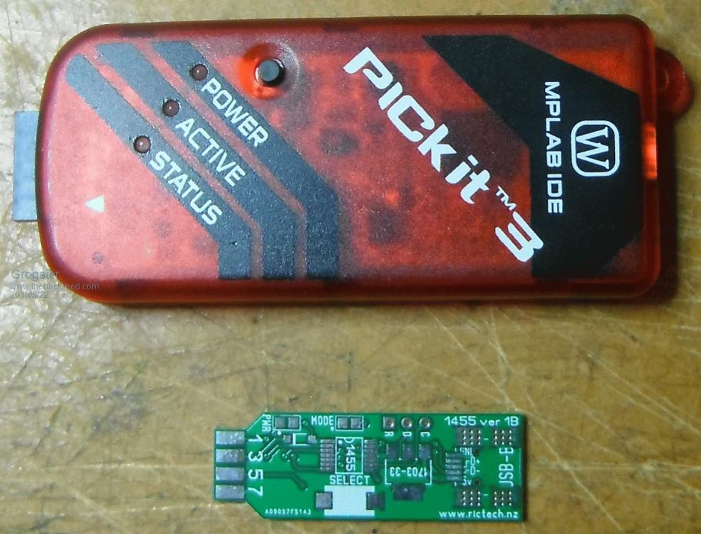

The PCB's for this have arrived. I hope to build one in the next few days.
Photo of a PCB shown with a PK3 for size comparison:

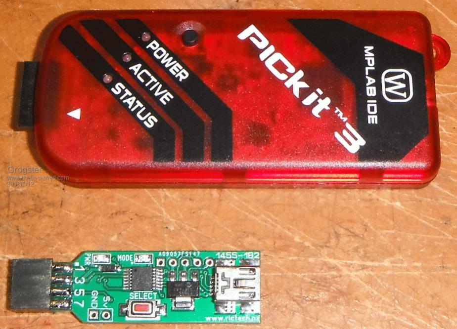

Updated version 1B2 with standard 5-pin 2.54mm ICSP holes for easy programming of the 1455 and a couple of other minor layout tweaks.
Shown with a PicKit-3 as a size comparison.

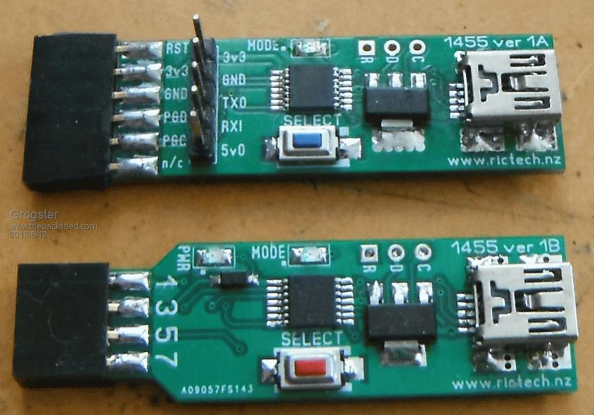

GDay Grogs,
This looks interesting.. but you have me a bit confused as to how it plugs into a standard 6 pin SIL header?
The pinouts do not seem to lend itself for that and look like they require jumper wires to connect to your device
Posts: 10043
Posted: 11:52pm 11 Jun 2018
It doesn't.
The ICSP 5-pin is there just so you can program the 1455 using a PK3.(ignore pin 6)
Once programmed, you don't use the PK3 anymore, you use the little board as a MM programmer and debugger unit. The 2x4 female header at the left end in the photos, contains all the connections for ICSP and also the console, so you can program new MM chips AND have the console connected all at the same time.
I got sick of swapping wires around between a PK3 and a serial module for the console, so built this thing which does both at the same time thanks to the 1455's ability to do both.
I have now started using a 4x2 pin-header on all my projects. It is reasonably small, and gives me the ICSP and the console in the one pinout.
EDIT: Here is a photo of how it plugs into a board:
With the ONE connection, I press the SELECT button on the little programmer/debugger thing, program in the MM HEX file. Once that is done, the programmer drops back to serial port mode, and I open a COM port to it - all without having to change anything or move any wires.Edited by Grogster 2018-06-13
