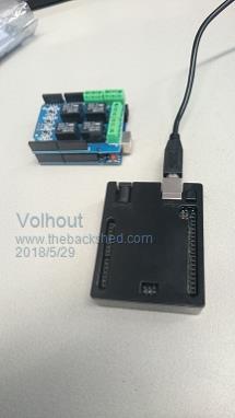

It's and ARDUINO ...... UNO at first sight
Oh wait ... it is infected by a bug ????
NO, it is an MX170
Arduino running MMbasic !!

Can you elaborate on this a little more?
Are you saying you have MMBASIC running on an Arduino?

  Grogster said   Can you elaborate on this a little more?
I suspect it's a "brain-transplant". The arduino been removed from the board and a MX170 soldered to the I/O pins so it fits the footprint and maybe takes advantage of the USB interface for the console. Nice idea.
I have toyed in the past with the idea of producing a MM board on the same footprint (shield) outline, but never needed to. Have used arduino shield boards but only singly and was ok with 0.1" rows of connectors.
One of my first forays into MM-beyond-the-breadboard was to do a brain-transplant of a PIC16F877 with a MX170 44-pin version mounted on a daughter board with the pins taken to two rows of 20x0.1" headers on 0.6" centers (i.e. the footprint of a 40pin DIP)... bit of programming and job done - still running today in my frequency counter.

It simply rewired the removed ATMEGA28 to the PIC170MX running Micromite basic 5.04.09.
Rewired the pins such that PWM pins end up dat PWM pins, I2C at I2C, Analog at analog, SPI at SPI. (some sacrifices have to be made... only 4 analog pins and 4 PWM pins versus 6 of each in Arduino).
But in general most Arduino shields should work 1:1.
The 3.3V regulator is also on the board and a resistor network for the RESET (5V->3.3V) so it is a direct plug-in for the ATMEG328P.
I had Tinybasic running on the Arduino, but became tired of fixing bugs in Tinybasic, and adding features to it, in this minimal RAM space. Decided to replace the hardware....
Geoff and others have done a great job in creating MMbasic. I know from Tinybasic how hard it is (and I even leapfrogged on earlier work).
Posts: 6118
Posted: 01:07pm 29 May 2018
But in hindsight, it is not a bad idea. The UNO costs something like 6 dollar shipped, the PIC costs 4-5 dollar, so for 11-12 dollar you have a more powerfull platform including USB UART, voltage regulators, reset circuit, headers. Cheaper than the (more powerfull) CircuitGizmo's Arduino outline micromite platform (29.99 dollar ex shipping...and TAX**)..
