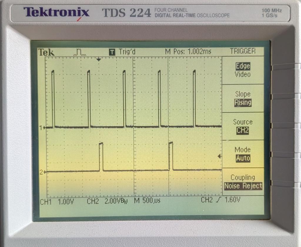

Posted: 12:51am 11 Jun 2018
Fantastic!!!! Working perfectly as designed.
As you mentioned, there is no error correction. I found a too wide a pulse gave an inverted output. Limiting the width solved that problem.
I also experimented with some gating pulses. The idea worked on the breadboard. Yet to be tested in real life though which may take a week or two. QLD Courts reckons I need to do Jury Duty. I'd better go.
EDIT OOPS Just realised that my gated pulses aren't correct. Should be after the pulse end. Back to the drawing board.
option autorun on
pwm 1, 10000, 50 'HF trigger pulses for the SCR, gated by PIN 14
setpin 15, CIN 'Trigger input
setpin 7, ain 'Sample volts in. 0-3V3
setpin 23, inth, trigger 'PIN 23 connected to PIN 15
do
width% = max(500, min(8750, pin(7) * 3000)) 'width limited from ~ 0.5mS to 8.75mS
pause 8 'simulating doing other stuff
loop
sub trigger
oneshot 14, 1000, width%
end sub
Trigger + Normal O/P
Trigger + Gated O/P
Edited by Chopperp 2018-06-12

  Quote  ONESHOT 0,0,0
Have you tried the code in the PicoMite?
I'm going to add an optional dwell period after the output before the thing will re-trigger. I no longer have the MM2 code and can't update it so if you stick with that you will have to work round any limitations. The PicoMite code can be fixed if not perfect.
Here is the result of my PicoMite version with the added quiescent period GP6 and GP9 connected.
setpin gp6,pwm
pwm 3,1000,5
oneshot gp9,positive,gp2,300,100,1000
'Wait a positive going edge on GP9 then pause for 300uSec, then 100uSec pulse on GP2, then wait 1000uSec before allowing a re-trigger.
Edited 2026-03-01 19:50 by matherp
