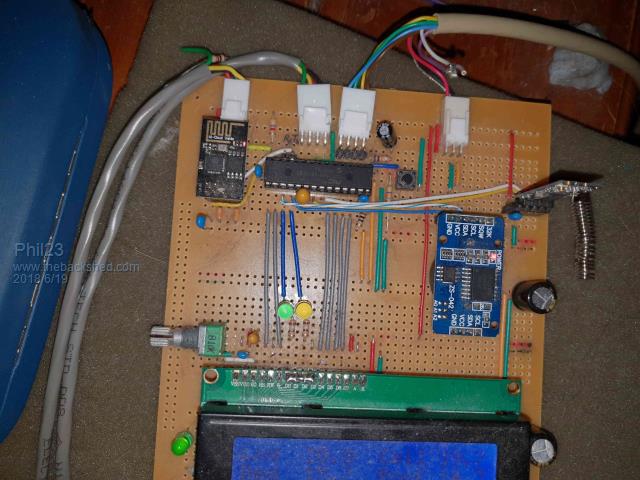

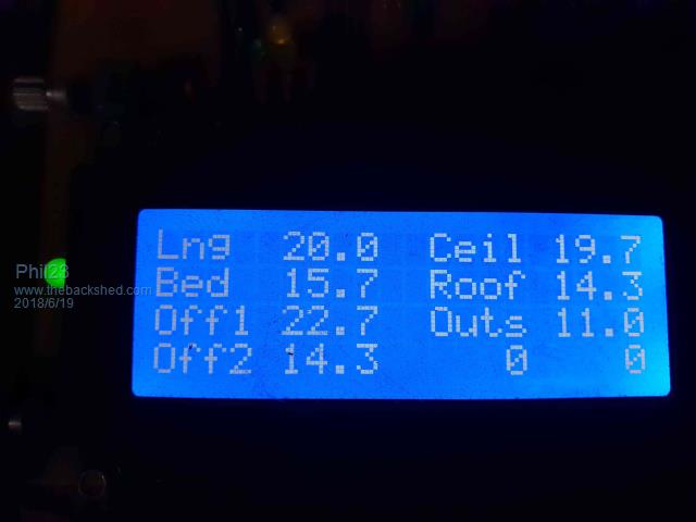

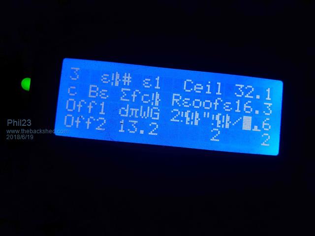

Hi All,
Every so often I'm getting a corrupted LCD display on my heat controller.
The code in the MM is still running fine if I check at the console & a reboot or Ctrl-C & run again fixes it, but it's obviously annoying...
Any suggestions at a hardware or software level for a quick solution.
Cables coming from the board got to a string of DS18B20's on the left plug & the other two (3) got to 2x 4 gang relay boards up in the roof.
Any suggestions?
Phil.

Azure
Joined: 09/11/2017
Posts: 446
Posted: 02:45am 19 Jun 2018
I see you have a couple of electro caps on the board. Being Veroboard the actual signal/voltage at the component pin may fluctuate from what you would expect.
If you have an oscilloscope you can check the noise on the 5v directly at the LCD while it is running. Possible some ripple or HF noise effecting it. It would pay while you are doing that to also check the control and data signals at the LCD to make sure they are also nice and clean.
You should try and monitor the signals during worst case conditions, when relays are switched and when the wireless unit is transmitting/receiving.

  Azure said   I see you have a couple of electro caps on the board. Being Veroboard the actual signal/voltage at the component pin may fluctuate from what you would expect.[/quote]
Yeah, I'm sure it's at the board, I have a few LCD's.
I also suspect it happens sometimes without relay activity.
Didn't know whether or not I should have used a few 0.1uF's on data lines etc.
That sort of stuff is not in my expertise..
Phil.
Edited by Phil23 2018-06-20
Azure
Joined: 09/11/2017
Posts: 446
Posted: 06:19am 19 Jun 2018
Are you able to check things with a scope or is that not possible? A multimeter will not really show what you need to see.
My suspicions would be firstly around power quality at LCD from noise or excessive ripple or dips during certain operations on power lines at LCD. If you can't check it and just want to try things a 100uF/220uF electro and a 0.1uf ceramic wired close to the LCD power pins may help clean up and stabilise the power at the LCD.
The WiFi board is probably the biggest power consumer during transmission after the relay board.
The Control and Data lines really need a scope on them to see if they are clean. On your board it looks like they are wired in fairly directly so they should be ok.

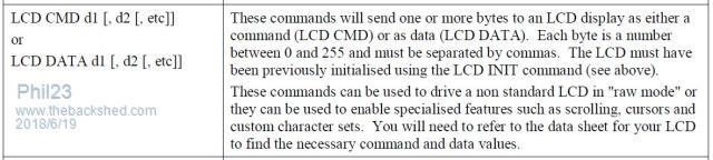

CircuitGizmos
Joined: 08/09/2011
Posts: 1427
Posted: 09:30pm 19 Jun 2018
Info here:
http://web.alfredstate.edu/faculty/weimandn/lcd/lcd_initialization/lcd_initialization_index.html
Here:
http://www.microcontrollerboard.com/lcd.html
From rusty memory, I sent 30h several times to the display, followed by 01h. Your 4 line will be slightly different.
Phil23
Joined: 27/03/2016
Posts: 1667
Posted: 10:26pm 19 Jun 2018
Just tried breaking to a prompt when I had just two characters of corruption,
sent in LCD CMD &h30 & it cleared the 2nd & 4th line & put more gobbly gook in lines 1 & 3.
Tried LCD 1,1,"hello" after that with no response.
Should have tried "hello" in a few places first, to see if it was still operational, as I'm assuming it's not, cause if it was each re-write should get rid of the corruption.
Need to find a list of the valid commands...
CircuitGizmos
Joined: 08/09/2011
Posts: 1427
Posted: 10:33pm 19 Jun 2018
I'm really sorry if I gave you the impression that there is one byte to send to reset the display. Display init is a sequence of bytes, like the two linked pages show.
