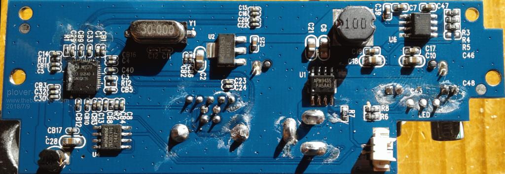

Because it had worked minutes before, I ignored my immediate thought " oh,no the drive carrier is dead" well I should not have ignored this unscientific response. After an hour I had to admit the box was dead. Out came the pcb for further investigation.
I decided that since I am doing this crash course in DEX operation I will use DEX to do documentation from the beginning and some other exercises with graphics and 3D, including recording photos in DEX. It may come down to drawing a schematic but hoping not.
A.. Using USB microscope I managed to get main component ICs identified, later a friend suggested using my smartphone as well and test various lighting arrangements. I am not much good on photography but it turned out that the smart phone idea was good.
On the board there is a Winbond 25X20CL VIG. Serial Flash memory. I have datasheet for 25X20CLSVIG, that is and S in front of the VIG. On my board there is definitely no S and I did not find any datasheet for "25X20CL VIG" my question is there any one with some working knowledge of such critters?

D.. It is my plan to try and follow up with some pictures and DEX work as I gain experience. I am going to attach a photo from my smartphone, 5 times magnification can be applied and apart from the lighting in this case is such that uneven result over the board.
What I am more interested in if anybody has suggestions for software that can straighten out or just tweak the picture so it fits real square
The board comes from a SimpleCom SD323 unit and I have searched for the schematic but so far not had any hits, I am hoping when getting around to look at the circuitry for individual IC's that guesswork from reference circuits will give a good idea of the schematics, fingers crossed

Your pic can straightened with either Photoshop or Gimp using warp or distort functions.
Clarity on the board could be improved by first cleaning with a flux remover and then useing multiple light sources to remove shadows. Use contrast, brightness and curves to even out lighting and finally, some unsharp masking to improve the edge sharpness.

Thanks for posting. I will get something done about a camera holder for my smartphone and lighting. I agree about the cleaning but time and risk of wiping out the prints while not too big in this case has me reticent about cleaning.

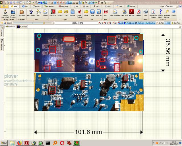

I am attaching a snap of the DEX experiment on the board. Top one was my first rushed go to get identification on the way. For this I am happy as I managed to get id of the IC's and located on the board, so that in a day or two perhaps a week or longer, when I will have forgotten much, I can go straight to the record an try to pick up. Have datasheets and had a quick look.
On the smartphone picture, yes the shadows give away that lighting is bad, I am thinking of a ring LED lighting. My fluorescent ring light on the bench mounted magnifier blew ater short time for a second time so I replaced it with an Oyster kit and I am happy with it, not perfect as I have no intensity control. But I may get one more of those second hand from Oatley if still available. Approx 120 mm diameter from memory
Errrrhh, I did something wrong, I think I tried to upload a DEX program file, I meant to upload a snap. Now I can not upload pirtures, so I will have to wait.
Errrhh 2: when closing down I found a window waiting from TBS, and the penny dropped why I could not upload the picture. I can make an upload here it is.

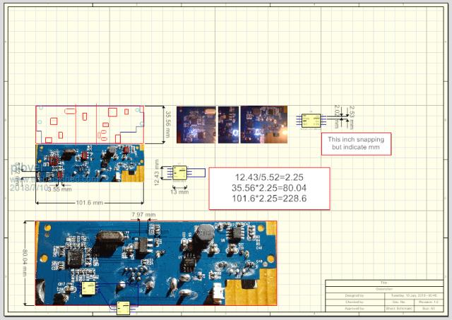

A bit more eperimentation with the images and precise distances used. Keep in mind only some conceptual thoughts are being tested in part.
I have moved one of the 'images' aside, so I have a 'silkscreen layout, there is a reason for that may become clearer later.
With the having a really good photograph I think I can place schematic symbols on top of the photo, then trace the pcb pattern to a degree, looks like I can get away with wiring runs from item to item.
Becoming clarer that I would benefit from being able to make som transparent behaviour to the imaged, so as to fade it away or just turn it on and off. Will se.
Have scaled the image to fit the symbol for a Winbond W25X20CL spi flash chip. I think I have pinned down the SPI flash chip.
