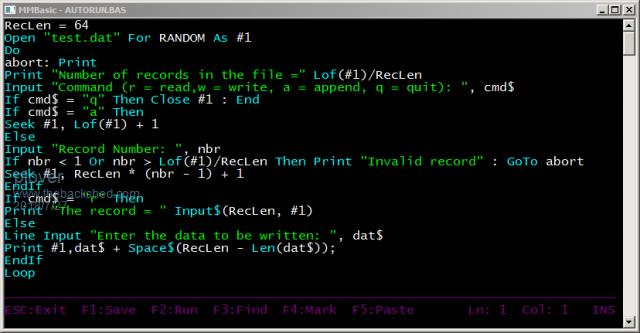

To me it seems it did not work, to me it looks like that integer variable dat$ should have had some content, if it does where is it and if not why not. I think I missed something vital about "records" perhaps some declaration might have been smarter?
Help please?

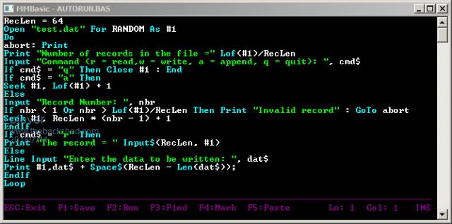

Oh I see further down the page here comes help.
> close 1
> RecLen = 64
> OPEN "test.dat" FOR RANDOM AS #1
Error: No such file or directory
> DO
Error: No matching LOOP
> abort: PRINT
> PRINT "Number of records in the file =" LOF(#1)/RecLen
Number of records in the file = 0
> INPUT "Command (r = read,w = write, a = append, q = quit): ", cmd$
Command (r = read,w = write, a = append, q = quit): IF cmd$ = "q" THEN CLOSE #1
: END
> IF cmd$ = "a" THEN
Error: No matching ENDIF
> SEEK #1, LOF(#1) + 1
> ELSE
> INPUT "Record Number: ", nbr
Record Number: IF nbr < 1 or nbr > LOF(#1)/RecLen THEN PRINT "Invalid record" :
GOTO abort
> SEEK #1, RecLen * (nbr - 1) + 1
Error: Invalid seek position
> ENDIF
> IF cmd$ = "r" THEN
> PRINT "The record = " INPUT$(RecLen, #1)
The record =
> ELSE
> LINE INPUT "Enter the data to be written: ", dat$
Enter the data to be written: PRINT #1,dat$ + SPACE$(RecLen - LEN(dat$));
> ENDIF
> LOOP
Error: LOOP without a matching DO

Looking at your post above, you appear to be entering commands at the MMBasic prompt? For quite a number of the commands you have tried, it makes no sense to enter them at the command prompt and all you will get will be error messages.
It might be an idea to download a copy of Geoff's "Getting Started with MMBasic" from his web site and work through the examples in there.
Perhaps start with simple 5 or 10 line programs to do things like INPUT to a variable and then output to the console.
There are plenty of examples in the manual referenced above.

Hey there.
Most commands CAN be run at the command-prompt in immediate mode, but there are several that CANNOT.
Any multi-line command, such as IF/THEN/ELSE will NOT work at the command prompt, unless the interpreter can evaluate the command in one single line.
The reason you are getting errors, is that when you press ENTER on your IF/THEN experiments, the interpreter IMMEDIATELY attempts to run that line of code. It does not work, as you are missing the rest of the multi-line statements, and the interpreter has nothing to execute after the THEN keyword, so it falls over with the error about no matching ENDIF.
Commands like those ones MUST be run as part of a program code, and they simply can't be run at the command-prompt in immediate mode.
EDIT: Well, technically, you CAN do it by separating out the commands using colons. You are still limited to one line of code, but you can do it along the lines of:
IF X=1 THEN:PRINT "TRUE":ELSE:PRINT "FALSE":ENDIF
That would probably work. Not tested, but it should.
EDIT: Just tried it, yes that does work. You really, REALLY need to be entering in the commands using the built-in editor(type EDIT at the command-prompt), so that you can run the code and experiment around. Typing the commands at the prompt like that is a waste of effort too, as the code you are typing will be totally forgotten once the interpreter has executed that line - so you are typing all that code, to have MMBASIC NOT remember it.
I know where you are coming from - entering in the BASIC at the command-prompt. The Atari 800XL I used to have years ago did it that way. Each line was entered at the command prompt, and saved as part of the program. MMBASIC does NOT do it like that. You have to use the built-in editor to write your code, and then use F1 to save it to memory. Edited by Grogster 2018-07-12

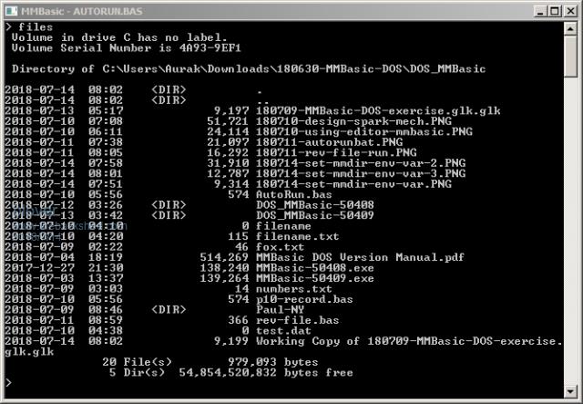

In the manual page 6
AUTORUN.BAS is described.
If a valid program file name is not provided on the command line MMBasic will attempt to load a program
called AUTORUN.BAS and run it. It will first look for this file in the default directory provided by the
Windows operating system and if it was not found there it will look for it in the root directory of the C: drive.
Ah, as the previous little exercise by running individual lines turned out to be a big flop. What about copy and paste the "failing" code to the Autorun.bat?
In my case simple, I have a file p10-record.bas containing the code ready to test so will make a copy and rename this AUTORUN.BAT
Then start up MMBasic.exe from same directory.

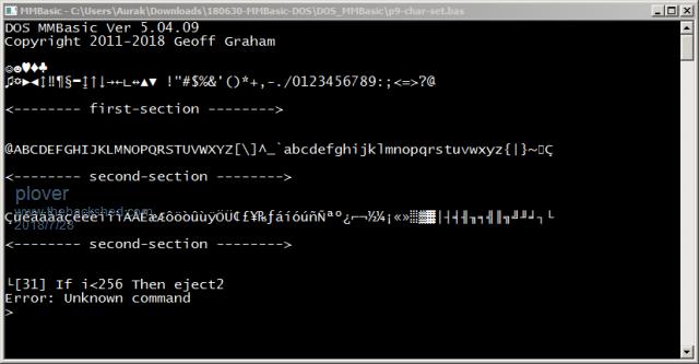

The following code is next in the manual, reading text in file in reverse order
OPEN "file.txt" FOR RANDOM AS #1
FOR i = LOF(#1) TO 1 STEP -1
SEEK #1, i
PRINT INPUT$(1, #1);
NEXT i
CLOSE #1

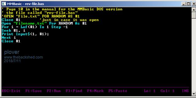

I can use this to test the file I thought I had made with the Fox and over the fence to the chook house. That exercise ended up with me wondering if there was anything in the file. Named the code file "rev-file.bas" and my code:
' Page 10 in the manual for the MMBasic DOS version
' the file called "rev-file.bas"
'OPEN "file.txt" FOR RANDOM AS #1
'Close #1 'just in case it was open
Open "filename.txt" For RANDOM As #1
For i = Lof(#1) To 1 Step -1
Seek #1, i
Print Input$(1, #1);
Next i
Close #1
To get the code into the MMBasic
To run the program, F2
[4] Close #1 'just in case it was open
Error: File number is not open

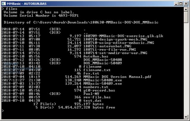

Oh, but the filenumber could have been open? How would I know if it is open or not, I tried to outfox the "already open" error. Hmm.
EDIT an make the CLOSE #1 line a comment then use F2 key, that is quick and easy
taht fo enon evah dluow lerekcoc eht tub ,esuohkoohc eht ot thgilyaD ni ecnef eh
t revo depmuj xoF nworb kciuq ehT
Now that was nice, I had managed to fill in some characters in the file, and the new little bit of code also worked.

I have had that open/close issue myself. IE: How do you know it is open or closed at a certain point. The simplest solution that others on the forums suggested to me at the time, was a flag. I used a variable such as FOF(file open flag), and just tested that before doing any closing of the port.
[Code]
If FOF then
Close #1
FOF=0 'Clear flag
Endif
Open "FILENAME.TXT" for RANDOM as #1
FOF=1 'Set flag for next time
[/Code]
This way, as soon as you try to open or close the file, it will first check to find out if the file is already open. If it is, it will close the file first, then re-open it. That kind of thing seems to get around the error that can pop-up when you try to close a file that is not open, or open one that is already opened.

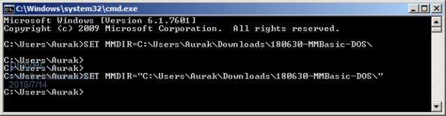

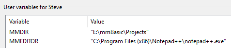

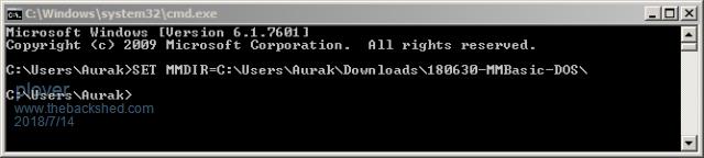

I have moved back to about p.4 in the manual, looking at environment variables, interesting because I am outdone from the start, bit of the manual, split it up abit in my exercise book, the quote from my boo:
  Quote  Environment Variables
Windows environment variables can be used to change some characteristics of MMBasic.

Following path line is where I have my running mmbasic.exe located and files as created etc. Presently this is where mmbasix.exe will run in that location.
SET MMDIR=C:\Users\Aurak\Downloads\180630-MMBasic-DOS\DOS_MMBasic\
So the test, I am going to try and get MMBasic to run in the parent directory, or one level back up the chain. As I understand done by setting env variable:
Done, then I check in the MMBasic terminal window with the "files" statement:
The files showing tells me that is the original location I started in tonight, but I expected to see the file in the parent directory??
I think I did restart, MMBasic from original location again, after I had caried out the SET MMDIR=... but at the same time I happened to read agin that the path should be quoated,@#$%, i have to repeat quotes
SET MMDIR="C:\Users\Aurak\Downloads\180630-MMBasic-DOS\"
Actually tried to put red colours around the " mark, that is no go.
SET path including the quotes. Then the make sure I had closed the MMBasic terminal window I then started it up again. Do the "files" test:
What, the same result??
Well making great progress here going backwards it seems. This is the way to learn I know but one does get a weeny bit tempted skip these basic things perhaps.
As this is run under windows 764 I am qurious where can I check the ENV list settings, in Linux with a bit of luck I can run a long list and actually see what the values are that are assigned.
Has MMDIR been assigned a value? I was hoping that running the "files" in the MMBasic terminal would have shown the parent directory (notice the "files" run result does show a path line.
Somebody drag me out the quicksand before it is too late.Edited by plover 2018-07-15

Aside from this, I can see you have AUTORUN.BAS in the directory. it may be that there are some commands in here that are changing your current directory which might be overriding any environment variable.(I am not 100% sure on this as it may dependent how you are starting MMBASIC...but if ENV setting MMDIR wasn't your problem, you could try temporarily renaming AUTORUN.BAS to something else and try it)

Wooww, better than I hoped for, the list of env variables.
I am going to attach terminal picture, but I see my thinking about how to verify if MMDIR was set, was good idea. From the list it is not set.
My thought was setting the env in a Windows terminal that might make it Global, obviously that has failed and as I accidentally also set it in root/admin terminal this did not do the trick either (nothing showing).
Your pathway to set the env variable, seems like hard work and it does not appeal to me as I will have forgotten in 3 days how I got there but might remember it was described here. Assume I will find out later if and what may be needed.
Add to this I don't know if I need to use it, not clear to me. I am just at the moment battling my way through the manual hoping something will stick in my head.
So locally you SET in MMBasic, and globally you take the tourist path via Windows. Then to check back into MMBasic and run the "system "SET"" and files.
