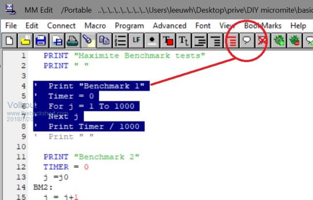

Posts: 6118
Posted: 07:09am 20 Jul 2018
Hi Paul_L,
The block comment is definitely something that is valuable.
If the '{ and }' are the best basic translations of the /* */ in C is to be decided.
Please realize that the block comment also has impact on but RUN mode and EDIT mode in the Maximite and Micromite, but also in MMEdit.
MMedit already has a function to comment out blocks. The hard way. Adding a single quote before every line in the selected block. Maybe you should use MMedit...?
Volhout Edited by Volhout 2018-07-21
