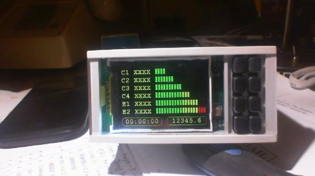

Posted: 10:13am 15 Aug 2018
A big thank you Geoff for the addition of the new internal Gauges to the new firmware..! Currently using both types in the DIN panel instrument design for the engine information system I'm trying to get done... Currently using 6 20 segment bar type gauges for CHT ant EGT thermo temps... Will be using the round gauge for RPM... The design uses the 470 MPU...
2018-08-15_201238_DIN_Panel_MPU_Engine.pdf
