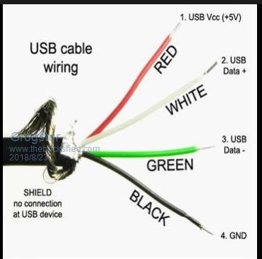

Posted: 02:40am 23 Aug 2018
I used this image from Google, to build a custom USB cable for something - which then refused to work. Bill kept on moaning that the USB device had malfunctioned and Windows does not recognise it. See anything in this image you don't like?

half the images out there have D+ as white, the other half have D+ as green. as to which way is correct, i'm not too sure! have been caught by this one myself

White is D-, Green D+.
The order is Red, White, Green, Black, (Shield).

The cable I am making is hopefully just a one-off. I got the cable from Jaycar, as I wanted to be sure it was of some kind of standard. Testing with the multimeter shows that D+ is green, as pretty much all of the other Google images show. I would have to pick the one that was wrong, wouldn't I.....

Made another end, and this time made green D+ and white D-. I also checked the black and red wires to be sure. THIS time, it worked just fine. I have now used it to program MMBASIC into a chip.
On the plus side, this WILL make me remember that green is D+ and white is D- in a standard cable.
