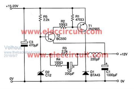

Sometimes I even grab my proven circuit with 2 transistors. Like this one.
Just change the zener to 5.6V and you get 5V out of it. And..absolutely NOT short circuit protected... keeps you sharp.

Interesting. I assume L1 = 220uH

There are many of these "simple" power supply circuits out there, and they do work. But you need to be a bit careful of anything that uses a series pass device.
Think about what happens if the switching device fails, and that may easily happen if there is no built in current limit circuit and you slip with a multimeter prod for example.
If you put +40v down the +5v supply rail because a series switching device fails shorted, then it can do massive damage, even destroy tracks on the board.
Its just not worth the risk. Much better to use a circuit design that always drops the output to zero under any mode of failure.
A capacitor charge pump (for very low power) or a flyback supply for higher power will just stop transferring energy if it does go bang, and the output power is naturally limited if it become seriously overloaded. When you remove the output short it just springs back.
