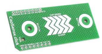

and there is this to play with
Capacitive Sensor Click Board Edited by Quazee137 2018-09-24

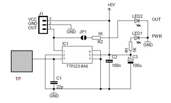

@ WW - Yes, I have seen those 4x4 touch-pad PCB's on eBay and AliExpress too. Cos I only wanted three 'Buttons', I acknowledged them, but ignored them. I do like the slider idea though!
@ Quazee137 - Another useful one. Thanks for posting the schematic, as that one shows the cap on the touch as being 22pF, so that gives me a reference point for my experiments, and is in line with the 27pF or so I was planning to start off with.
