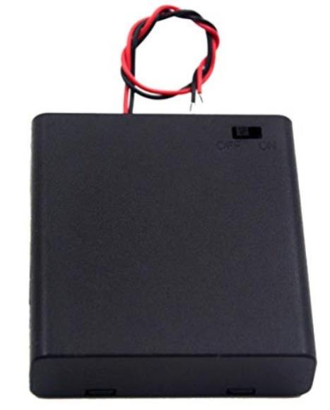

Not to hijack this thread, but it's already forked to a degree--is there a 3-AA or 4-AA NiMH box with plug-in for 5V phone/r-pi charger and charging control? Something like the standard 4-AA box with switch, but with a little more in the way of smarts?
