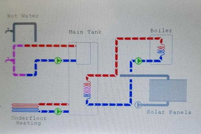

Hi -
Fairly new to MM so forgive what may seem a naive question.
In VB, there is a command DOEVENTS which will process other things while waiting for something (like a display update) to happen.
In MMBasic, if I use the PAUSE command, does processing just stop (apart from hardware interrupts) or can other things occur?
The question arises because I am writing a controller interface that shows circulation of water as an 'ant trail' using a custom font and pausing 200mS between rewriting the string to give the 'movement'. Am I just blocking the system from doing anything else while this is displaying, or what?
If so, I'm sure there's an obvious workaround, but I haven't yet discovered what it is!

Easiest is to 'simulate' a pause.
You can do that by using a state machine and check the timer value.

During pause MMbasic will process Ctrl-C, buffer UART I/O, Process GUI events, keep the clock running, process FIN, CIN, COUNT, check for pin interrupts, keep PWM running - basically everything except process inline Basic statementsEdited by matherp 2018-10-22

Thanks for the information above. I was hoping that there would be a way of accessing something like a timer interrupt, such as is available in the basic chip architecture, but it seems there isn't.

I don't understand why are you not using a SUB as Microblocks suggests?
Print Timer
my_pause(500)
Print Timer
end
Sub my_pause(duration As integer)
Local t=Timer+duration
Do While Timer<t
End Sub

You can also very easily create a pause that doesn't pause.
do
' do something here
PauseEnd=timer+interval
BeginPausedStuff
EndPausedStuff
'do something else here
loop
Sub BeginPausedStuff
' start the paused routine
EndSub 'BeginPausedStuff
Sub EndPausedStuff
if timer>PauseEnd then
' wrap up the paused routine
endif
EndSub 'EndPausedStuff
The loop will continue cycling doing other things until the timer exceeds PauseEnd at which time the pause termination code will run.

As I said at the very beginning, MMbasic is fairly new ground for me, and I had not appreciated the availability of SETTICK, which would seem to be the ideal solution to my problem!

Following the help received previously, I have now achieved the desired result in my water circulation modelling!
I adapted Capt Boing's timer routines but used a different strategy from that shown in the example given by Gerry (above).
This shows a (rather poor) image from the panel:
or you can see the animation itself on this link: Animation
In an effort to reduce processor time and storage, I elected to create a new font, using FontTweak. Each symbol has up to three variants showing the chevrons in different positions. The program then 'prints' the characters to the screen every 200mS resulting in the display shown.
I haven't yet analysed the actual processor load, but my impression is that it is light. The font and the timer routines take up just 8% of the Library space which should leave me plenty for the remainder of the program!
