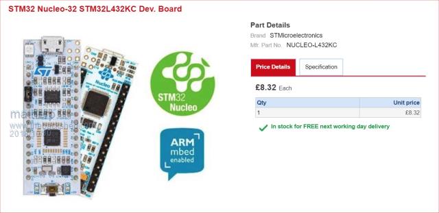

I've done some more research and I think I'll base the port on the STM32L432KCU6. This has the advantage that there is a very cheap Nucleo board available complete with onboard programmer (NUCLEO-L432KC)
It is a 32-pin chip, unfortunately only available as a UFQFPN-32, but these are still hand solderable (just) and given the availability of the Nucleo it seems a logical choice - thoughts?

I REALLY like this idea also. The small dev board is nice too. Just out of curiosity, how difficult is it to port to different pincout STM32 chips overall once this port is complete?

I am also interested. The price for the Nucleo board seems also good.

+1 for low power STM micromite with dev module currently available at a reasonable price.
I appreciate the great work of Peter and Geoff, and especially the continuing eye for expansion of Micromite capabilities.

Just wondering, but why that particular STM32L4 board/chip?
Why not, for example, the NUCLEO-L433RC ?

By far the most popular Micromite is the 28-pin which covers most peoples' requirements. The STM32L432KCU6 (0.5mm pin pitch) is very equivalent to the MX170 (although faster and with H/W FPU). The NUCLEO-L432KC can plug into a breadboard or be mounted on veroboard and the main processor can be powered separately from the ST-LINK to minimise power usage. This allows the Nucleo to be used as a PDIP chip something you can't do with the bigger versions which are also more expensive.
IMHO there is no point having things like GUI functionality in a low power device as TFT displays are incompatible with low power. I was intending to include support for displays like the NOKIA 5110, OLEDs and possibly the various e-ink versions in the firmware rather than things like the ILI9341/SSD1963
One downside of STM32 chips is that variants with different numbers of pins have the same device ID. This means that the code can't automatically configure itself for the number of pins making support for different version more difficult - separate executables.
In summary, I certainly don't want to limit the usefulness of the port by going with the smaller chip but my instinct is that the advantages outweigh the disadvantages. As always I'm interested and open to feedbackEdited by matherp 2018-11-01

It was mainly the number of pins I was wondering about - but just wondering, not overly worried or anything.
The chip/board cost is really good either way.
I suppose a downside of more pins would likely be more power, even if not much.

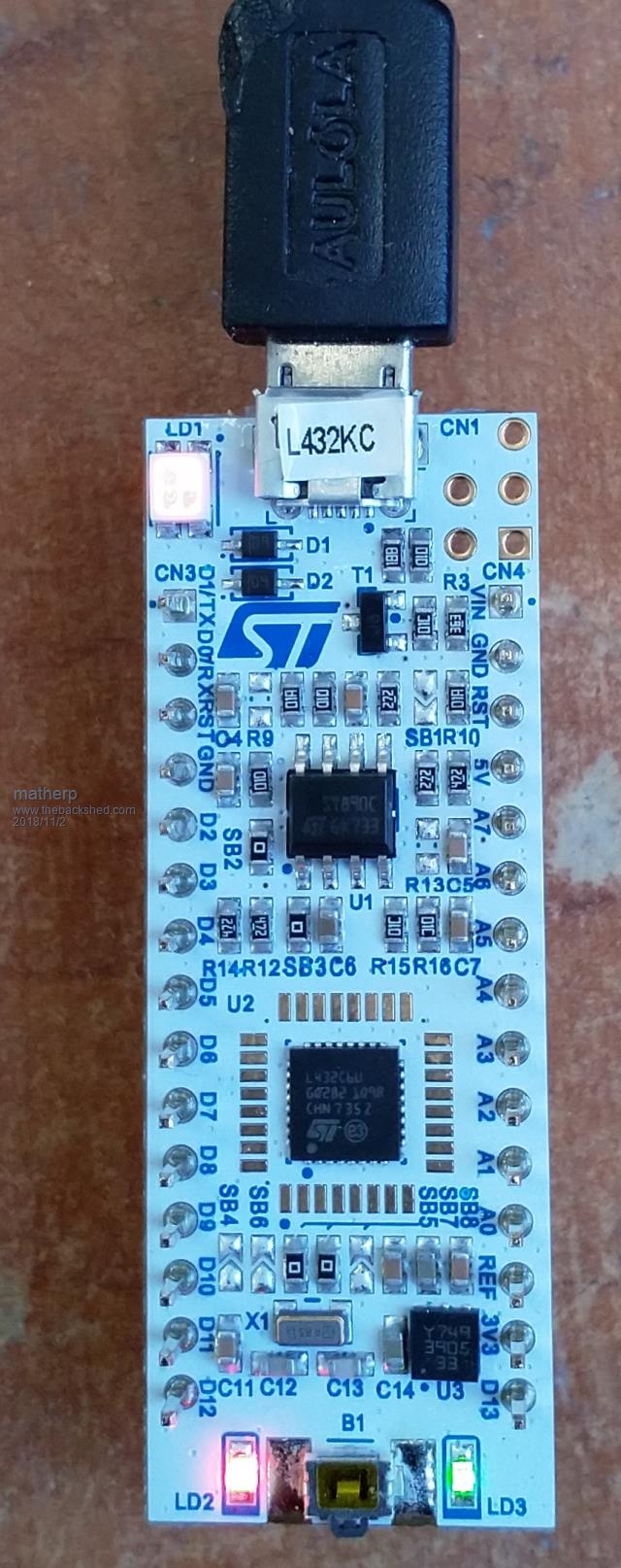

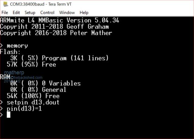

MMBasic is up and running on the NUCLEO-L432KC - this thing is so cute - the same size as a 40-pin DIP and totally self-contained.
The code moved from the Armmite H7 pretty easily I2C, SPI, Digital-IO etc. all up and running. The big changes as always are in the memory model and the way flash memory is arranged.
I've got one issue with the console output occasionally dropping characters and haven't yet implemented any displays yet or played with the low power modes. The board labels the pins A0-A7 and D0-D13 so I have allowed this nomenclature as well as the normal pin number. Pin D13 is connected to LD3.

Wow Matherp! This is very cool. Will have to order a couple of these now for sure. Digikey carries these over here for $10.99 and has plenty in stock. Thanks for the effort!
Posts: 3881
Posted: 12:55pm 02 Nov 2018
Wow. This is outstanding. Here's the Digikey link for U.S. buyers: NUCLEO-L432KC
The low-power stuff is great, but this also looks like a wonderful general-purpose Micromite board--I hope to see as many features as possible implemented.
Thanks, Peter (and Geoff) for this amazingly flexible piece of software fitted to ever-more powerful hardware.
