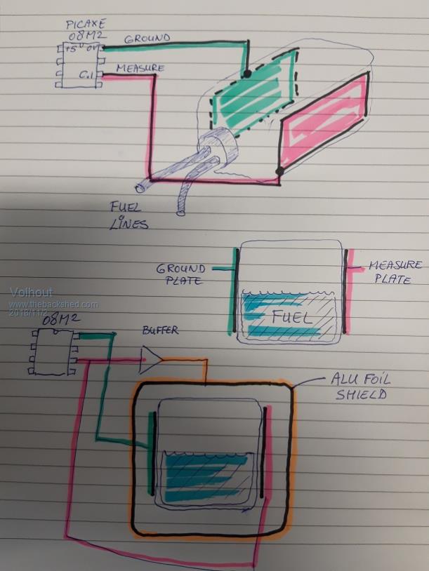

This circuit is a PICAXE 08M2 based interface that measures the fuel level in the airplane tank, and translates it into a voltage.
The voltage level is proportional with the fuel level in the tank.
The fuel in the airplane tank is a mixture of methanol, oil, and nitro. It is quite an aggressive mixture.
Putting electrodes or sensors inside the fuel is risky, corrosion is to be expected.

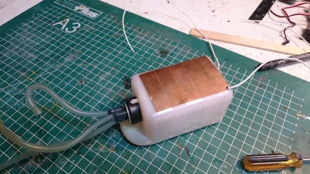

Therefore a solution was engineered to place electrodes outside the (plastic) tank, and measure the tanks capacitance.
How does that work:
Left and right side of the tank are equipped with thin conductive plates (in my case copper), forming a capacitor (see picture).
An empty tank is filled with air, and the capacitance (ignoring the thin plastic tank walls) is based on the relative permeability of air (=1).
The math behind it can be found on
what is a capacitor

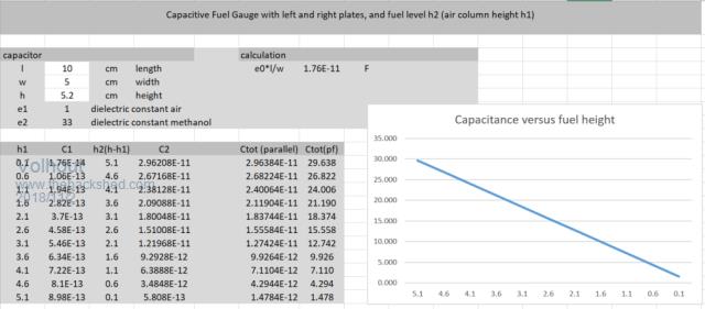

Look at the section on parallel plate capacitor. C = eA/d
If the tank is filled with methanol (relative permeability = 33) the capacitance is 33 times as high.
If the tank is half full, the capacitance is in between these 2 values.
From experiments (later confirmed by calculation) the location of the plates determines the exact relation between fuel level and capacitance.

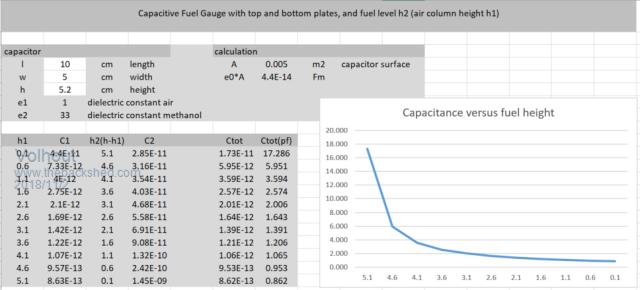

If the 2 conductive plates are place top and bottom, the relation is highly un-linear. But if the conductive plates are places at the sides of the tank the relation is linear.
The attached picture shows a fuel tank with top (and bottom) plates.
Best results are with plates at the sides.

Typical method of shielding the outside world from the fuel measuring system is by putting a conductive shield around the whole measuring system.
Since weight is an issue in model airplanes a proper shielding material is kitchen foil (aluminum foil). It is thin, lightweight, and conducts on both sides.
To be honest, it is a challenge to get a good cover of thin aluminium foil inside an airplane hull since access is generally narrow.
You only need to apply the foil in the section where the tank is located.
It is not necessary to make the shield out of one piece, since (with sufficient overlap) the foil pieces will conduct - or - form a large capacitance. Many times bigger that what we are measuring with the capacitive plates at the tank, so it will still work as a shield.
First test where performed with a all foil shielding connected to the battery (minus pin).
What appears obvious happened: the capacitance change from filling the tank was only a small percentage of the total capacitance.
This makes the system inaccurate (measuring a small change on a large value).
Explanation: in my airplane, the plates in the tank are 5 cm apart. But the shield was less than 1 cm away, forming an additional capacitor that is 5x larger in value (5x closer). (formula C=eA/d where d=distance)

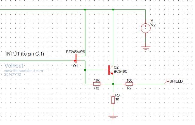

A friend of mine suggested to connect the shield to a low impedance (so it will work as a shield) replica signal off the signal at the capacitor plate. In that case there will still be a capacitor, but the electrical field between the shield and capacitive plate is 0. This was engineered, and proves to be the solution.

The signal for the shield must be a low impedance signal derived from the very sensitive TOUCH pin.
The buffer in the schematics in the first post (BF245A and BC549C) will do this. The BF245A FET input is very high impedance, and the BC549C output impedance is low. The buffer has a gain of 0.99 (almost 1).
Please make sure when you try to duplicate this circuit that you use a BF245A, not a BF245B or BF245C. Only the BF245A will work on 4V-6V battery voltage.

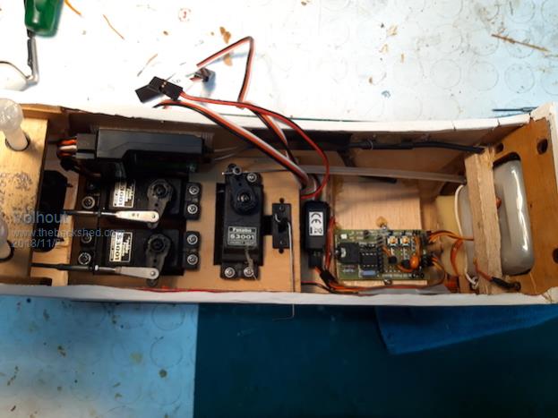

I was able to put all electronics on a PICAXE 08 Experimenter board (see picture first post).
Since every plane is different, I decided to add 2 buttons that allow to calibrate the fuel gauge for empty and full tank. If the plates are placed at the sides, the relation of the DAC output voltage will be linear with the fuel level. Max voltage = 4 volt (full tank), minimum is 0 volt (empty tank).

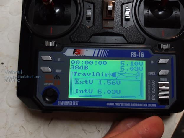

The output of the DAC is connected to a "voltage" telemetry input of the RC receiver. Attached photo's show the Telemetry reading on the transmitter LCD (the value ExtV shows the tank is 1/3 full (1.5V of 4V range)).
Another photo shows how the stuff is build into this airplane.
From left to right: top=receiver lower the 2 servo's for elevation and rudder), centre the throttle servo and power switch, right the telemetry input module (CE mark) and finally the PICAXE circuit. Extreme right you can still see part of the fuel tank.
