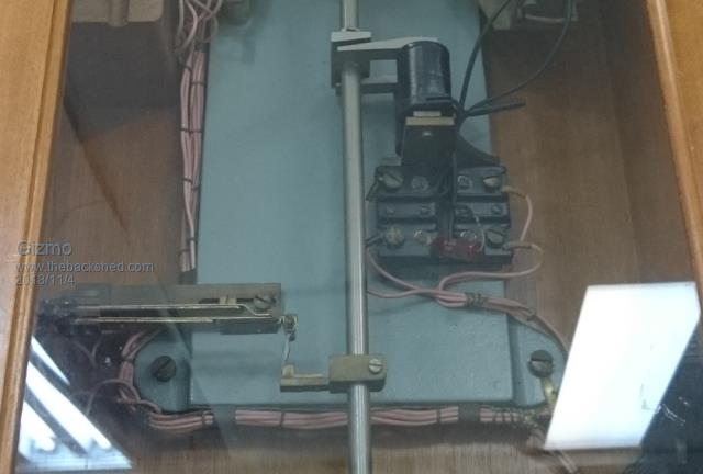

Old Telecom time keeping clock. The contacts only close when the pendulum swings dont swing far enough. The coil above it has a tapered pole, to attract the pendulum smoothly. Also remember, you cant change the duration of a pendulum by giving it more force to swing, only by changing its length.
